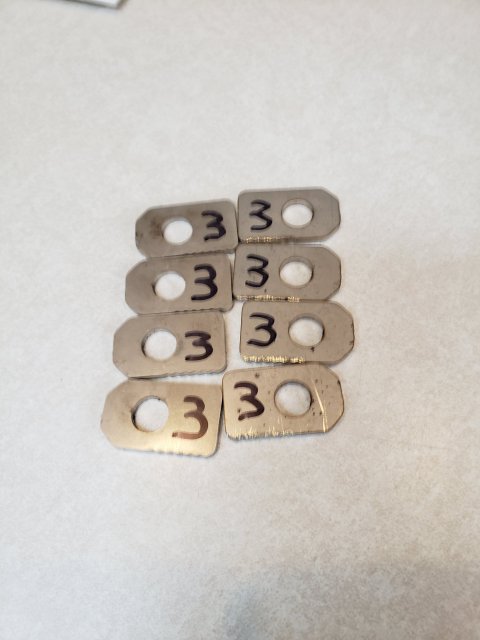

The aad stuff is pretty easy. Also I went in and wrote numbers on them so I didn't have to look at chart every time and figure it out. The notch system they use on the tabs isn't the best to determine which one it is 20231005_160544.jpg
