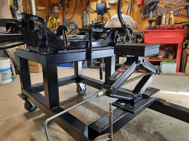

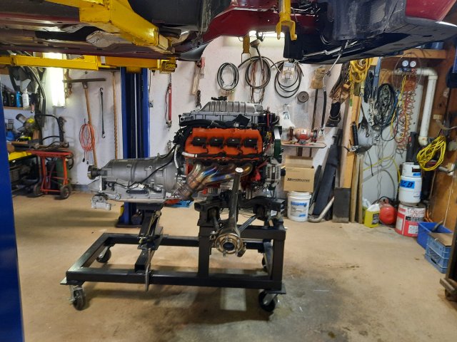

If you have access to a 2 post hoist.
This Cradle works like a charm for bringing the engine down from below.
You also do not need to remove your hood.
You would first let the k-member, engine & trans assembly hang from the car by loosening the 4 k-member and 4 transmission crossmember bolts about 3/8" out evenly, then let the car down just to make k-member contact the cradle, then raise the transmission scissor jack snug under the trans.
(Of course prior to this you have disconnected everything else to allow this assembly to come down.)
You then completely remove the 4 k-member & 4 trans cross member bolts and slowly raise the car making sure you have not forgotten to disconnect anything or that it might just get caught on something.
You can leave the A/C system sealed by just having another set of hands on a six foot by ladder holding the Compressor away from scratching the block and valve covers as the car is being raised.
What I did by myself was bungee cord it off to the side and placed a heavy cloth over that section of the engine and raised the car inches at a time then get up on the ladder and make sure the A/C compressor was sliding by nicely plus looking for any hang ups as I am bringing the car up until it was clear like what oilburners picture shows a few posts ago, then just roll it away.

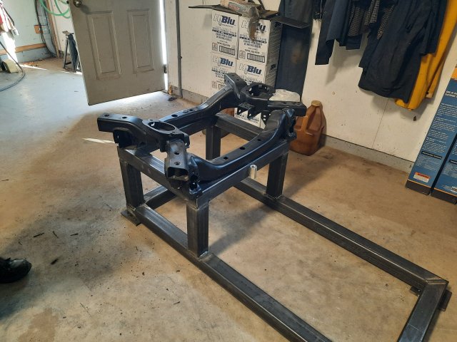

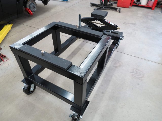

here you go @BULL or anyone else interested
main frame is 5ft long by 28 inch wide. box on top of frame is 15 inch tall, same width as main frame an 23 an a half inch long.
all square tubbing is pre cut including angles by steel supplier. all tubbing is 3 inch by 3/16th wall.
heavy duty 6 by 2 inch casters that pivot 360 degrees for those fine movements when aligning locating dowels that fit in factory cradle holes.
separate support under oil pan to enable trans. removal. trans. support is adjustable. rubber pad so not to scratch cradle frt an rear.
this thing can roll around the floor easy like a large costco shopping cart.:giggle:
very sturdy.
this was @DemonSRTs idea an design. I keep telling him I was just the welder;)
if anyone that does a lot of engine removals on this platform, would want this in their shop.

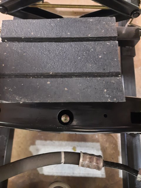

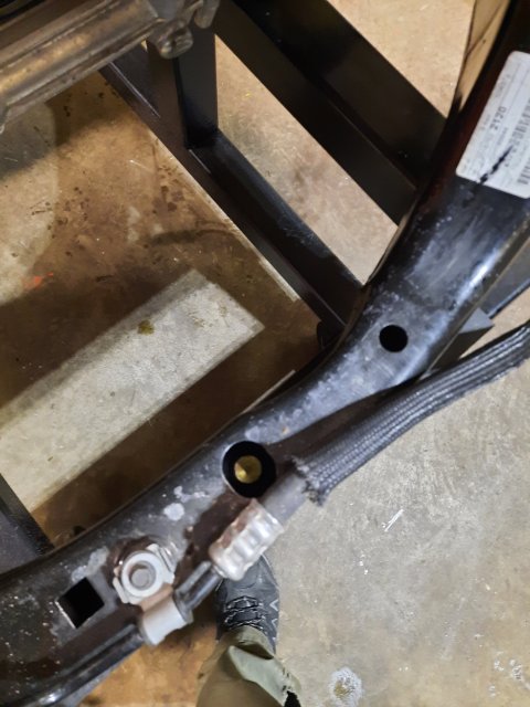

Here is a picture showing the pins that help keep the K-member in place. IMG_2150a.JPG

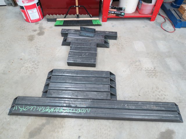

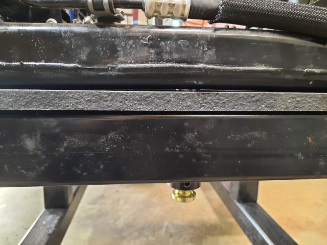

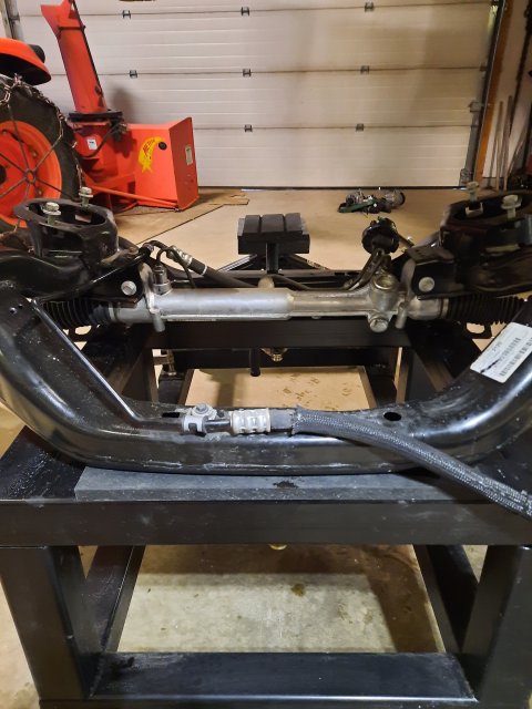

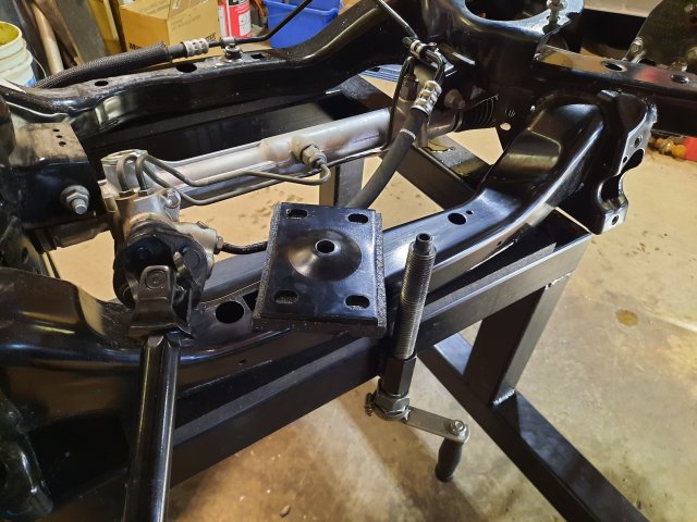

you will have to measure the distance between the 2 holes in the K frame for your 2 centering dowels an were the big nut is welded for your oil pan support.
notice in the pic the oil pan support is not in align with dowels ,its offset.
if you run a string frt to rear through the frames holes you will see it.
its important you transfer the measurements from your K frame / oil pan to the dolly.
the dowels on this unit fit precise an maybe a smaller dowel would be a little more forgiving.

Thread Starter #14
The locating pin holes in the K-member of the LX/LC chassis, (300's, Magnum's, Charger's & Challenger's), from day one to present are in the same location and size. I just need to confirm if the AWD vehicles are also the same as I have not worked on one of them yet to find out.
