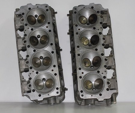

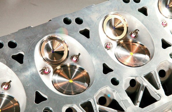

Agreed, modern "HEMI" motors aren't even hemi-spherical at all!
Somebody post up pictures of the two combustion chambers and it will be immediately obvious.

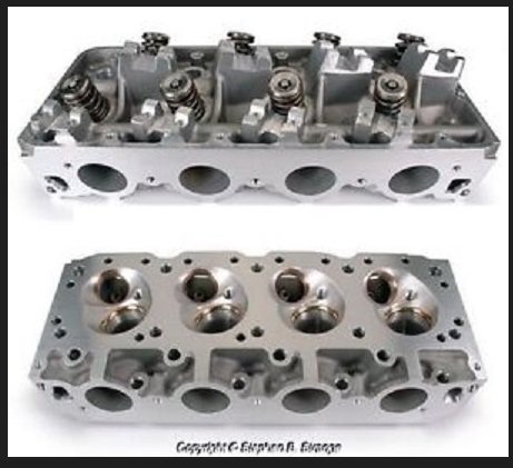

the basic design architecture of crossflow air path, dual rocker shafts, top-center spark plug(s) carries through. The Gen3 improves in several areas that technology advancement over the years revealed certain shortcomings of the Gen I and II, especially when normally aspirated.
Gen 3 is sort of a squashed hemisphere. Interesting that the Ford Boss 429 was similar. All had splayed pushrods and canted valves.

The 2 engines are very close in design, both share intake and exhaust ports that are laterally opposed, valves sitting at an angle on top of the combustion chamber, also double rockers. Yes, the chamber on the newer engine is almond shaped. According to Chevy/Ford guys this make it not a Hemi. I guess the Gen II(426) engine isn't a Hemi either because the chamber on the exhaust side is slightly shortened so it would fit in passenger cars(not a true half-dome) lol. Also, I believe Tom Hoover had some input on the Gen III design-raised cam tunnel, twin spark plugs. Both engines are pretty damn similar in my view.
