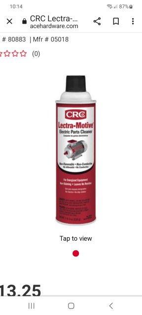

CRC makes a lectra motive spray that I use on electrical contacts. Not sure if it's right for your situation.

DON'T SPRAY ANYTHING IN ANY BUTTON!!!
The return on these buttons is a rubber membrane. They are not old school mechanical buttons.
