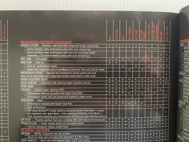

2016 sales brochure says active performance stainless steel pipes 2.75”. It doesn’t elaborate past that.
