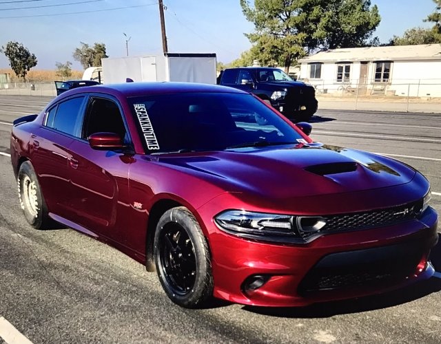

SpankinTime Motorsports just did one in a customer’s Scatpak Charger. Built 392 with a 3.0 Whipple making 1100whp now. He ran 9.3 at 150 full weight. It wasn’t a simple switch and involved a bit of trickery to fool the pcm to accept it as her own.

In our case it was much more cost effective to take one of a number of hp90’s parked in a corner of the shop and transplant it when you know how to do it, than to pay someone else to build a 70 to take that hp at that weight. David…. Is it even possible (within reason) to build a hp70 to the 1100whp/4700lb level? Not that that applies to the op but considering we hijacked his post already 🤓

9.31 @150 on a 6 rib serpentine belt at 4700 lbs. Hp90 trans with a 3.09 gear. 7521737B-CDB0-45E9-B9D6-E18EA5719E25.jpeg
