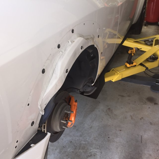

I looked into it.. there are a ton of small differences and some big ones. The bumpers, side marker lights, fenders, quarter panels, fender liners, rockers and splitter.
I even got an estimate to do it with all OEM parts, and it was 18K without wheels and tires. It could be done for less, but you’d be cutting corners.
In the end it will be a converted car, your insurance may not cover the new additions and it won’t have electric steering.

it has been done but its really expensive and needs to be done by a good body shop, its a lot of work.
Having paint modifications done. No engine performance adapted but the insurance company wants to see it in all it's beauty.

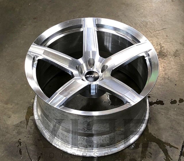

Here is what I tried to order.
They wouldn't sell any of it without the Demon or widebody VIN.
I was going to do the wide body convert with a set of DM-840 wheels.
With these centercaps

Wow, those caps are something else...can you get them in black/matte grey w/head outlined?
TMAC
#998
211
315
Mesa
2017 Dodge Challenger Hellcat
Got them off Ebay. Not cheap. The guy had one other set left.
