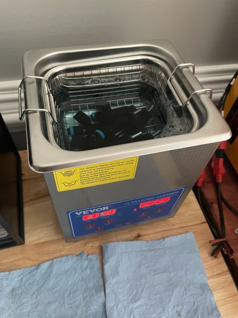

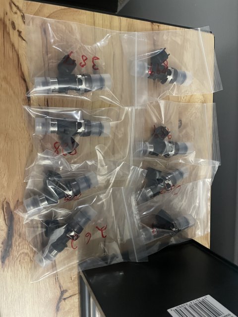

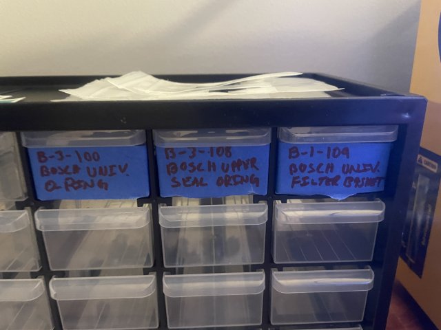

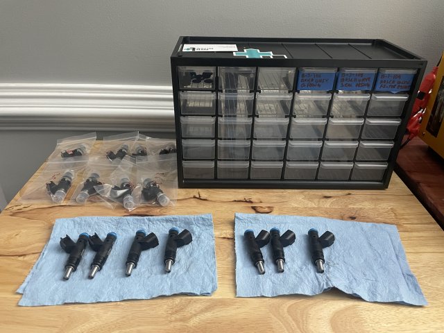

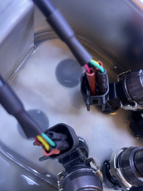

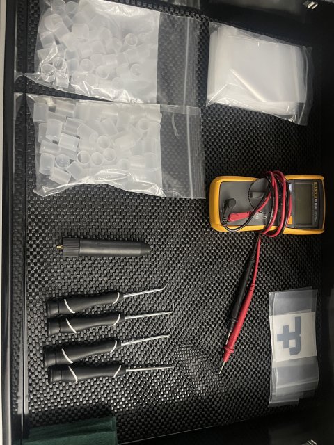

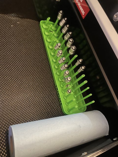

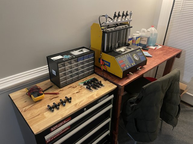

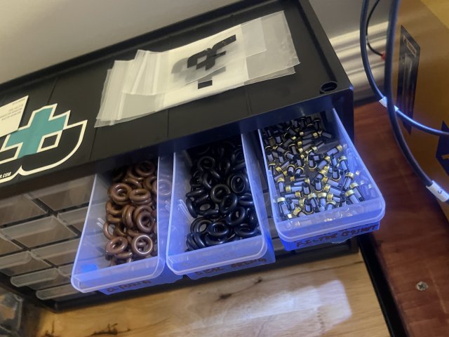

Just kidding, partially. Just wanted to give the community at large a heads up that I've been learning how to clean and service injectors. I enjoy it enough that I bought a quite sizeable machine to do the work, invested in fluids from Injector Rehab and Ultra-Flow and all parts to service your injectors. I'd like to offer this service to the community at large and I started Injector Cleanup (website soon!). I'm trying to do this right so I went the official route and got a nice shiny green vendor badge. I am currently able to service Siemens (stock Chrysler mostly), ID and FIC injectors. If you have other types/brands of injectors I will gladly service them but they will take a little bit longer to process as I don't keep the uncommon injector parts in stock (ID and FIC are Bosch just in case you are wondering) but can get them easily and quickly shipped.
As a highlight what I do to service your injectors:
  1. Ohms check (gatekeeper check)
  2. Static ultrasonic cleaning in my bigger ultrasonic cleaning tub.
  3. Dynamic ultrasonic cleaning pulsing the injector in ultrasonic fluid
  4. Pressure leak check at 75 PSI
  5. Acceleration check x3
  6. High speed test at 43.5 psi x2
  7. Medium speed test at 43.5 psi x2
  8. All o-rings replaced
  9. Caps added if missing
  10. Bagged and indivi
All metrics are recorded and put into a report and then emailed to you. 24 Hours after sending the report expect shipping and they are out the door. It's simple, place an order on the site, throw a copy of your invoice or invoice order number in the box with the injectors and first come first serve (packaging instructions are on the site). I'm still working out the kinks on a lot of this but I think by this weekend I'll have the site fully functional and ready to go for smooth buying experience. Sadly the longest part has been waitin for LLC and EIN numbers to process. Thanks Uncle Sam! I've already processed a few sets locally, I'm also able to do sell/share where if you have a set of injectors that you want to sell, I can service them and post them on the site for sale... win-win situation unless you want to chuck them up on the for sale section here, but if you've been running them hard you should definitely get them cleaned/tested.
Of note, if an injector fails the OHM check (reads 0L) the injector will be marked as unservicable and the client will be notified immediately. Here are some pics of my humble setup.
23ED0C58-ED6E-4E62-B325-217CA87AFE78.jpeg 6823344B-1D7B-474E-BA81-92B11E463305.jpeg 8F4EC422-6092-4520-9C28-C7F458A565CB.jpeg A062E302-C5C1-4951-B7A0-DCDA7B5E6880.jpeg 1C599173-5820-454E-A23B-FA72F78C5236.jpeg 3B4A60A7-2DA1-402C-8B1D-B360A7DDFD6A.jpeg 8C2FA444-5C39-4384-B162-9C642ED7FE3D.jpeg
First set of injectors ready to be delivered!

Yikes, big investment and lots of work, good luck!
When I cleaned the injectors on my GTO, I first ultrasoniced them, then I lathe cut a piece of delrin to adapt the tube of the spray carb cleaner to fit the injector, and a 1.5v battery to actuate the injector, then sprayed continuously while cycling the injector. Seemed to work.

Doing upgrades already. Once the injectors pass ohm testing. Just gonna wholesale bathe them.
then after a dry off period, then ill do the pulsed ultrasonic cleaning at the machine, less fluid swaps and cleaner fluid all around.
