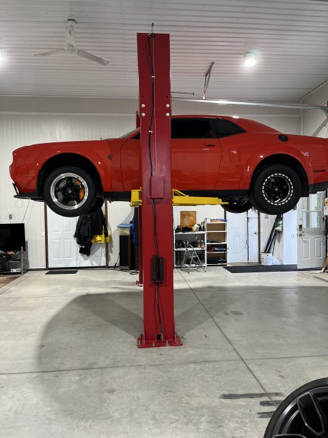

Well the car is “done”, other than an alignment, so it is just a matter of waiting for the good weather to hopefully show up in a couple of months.
In the meantime I decided to go ahead with a mezzanine project I have wanted to do since we moved here about 2 1/2 years ago. We live in a barndominium style home that was built in 2020 and although it was framed in during construction, there wasn’t an entrance to the shop from the second floor, which is our main living area, so I decided to go ahead and finish it.
So although this isn’t a post about the car it is the car’s place.
View attachment 177893 View attachment 177894 View attachment 177895 View attachment 177896 View attachment 177897 View attachment 177898 View attachment 177900

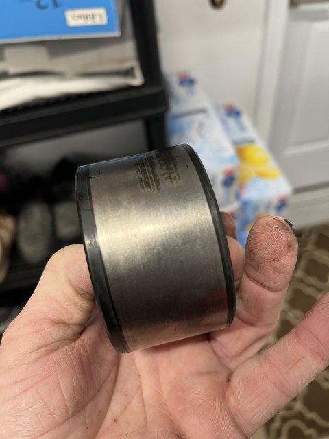

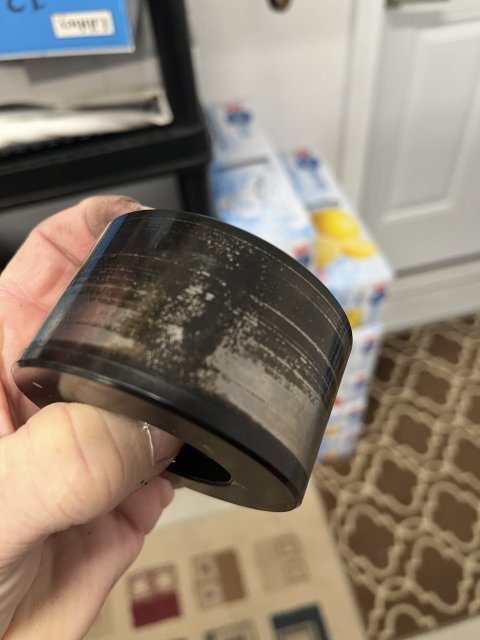

So I decided to replace the tensioner and idler pulley with the Metco product as I did notice that although the bearings seemed ok it was visibly obvious that the belt had been slipping on the pulley as seen by the pictures below

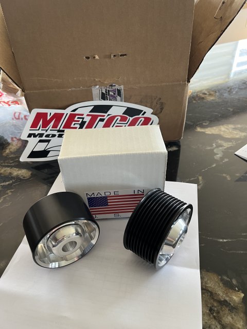

The Metco pulleys not only looked a lot nicer they were considerably lighter. IMG_7974.jpeg
