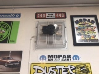

My garage doors and ceiling in Wildwood, FL are insulated but it does not do much to keep the garage cooler. Walls are cinder block and do not seem to be the cause of radiating any heat inside. I think it’s just from the attic? I’m going to put a solar powered exhaust fan in the attic roof to try to get some hot air out of the attic. That may help but I really don’t want to spend the money for a split level A/C system. I put an in the wall heat pump unit in my garage in Virginia that I bought from Grainger’s and it works great. Of course, the garage is also insulated.

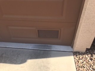

No question. An insulated door will be better than a non-insulated door. I have seen small screened louver’s installed in the bottom of a door. Maybe you could insulate it and use a floor fan to exhaust the hot air with those kind of louvers in the door...

Before the split level went in we tried the exhaust fan up high and the inlet vents down low on the garage doors. It was better but in the end we went with the split level.

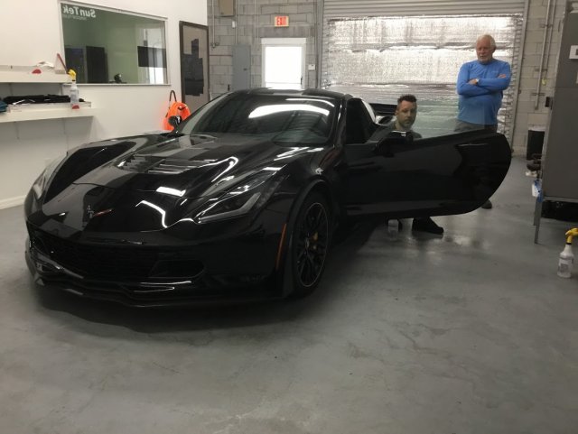

I would pick up a couple of sheets of the foam / aluminum sandwich stuff at Home Depot....try it. I did the bubble wrap on this roll up door at my kids tint shop It helps
I've thought about that too. My doors face west, so the sun blasts them all afternoon & evening.
Figured that stuff is easy to cut & should slide right in under the hurricane bracing. Maybe a dab of construction adhesive here & there to hold it against the door.
$60M question would be - will it add enough weight that the door springs will need to be re-tensioned ??
