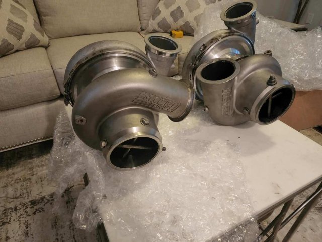

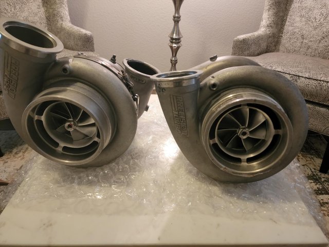

The 98mm precision turbos 5238B763-D674-46A3-A9FD-915A5CC026B7.jpeg DF82CE7E-4FC4-42BB-AE7E-CDFA176E719D.jpeg .

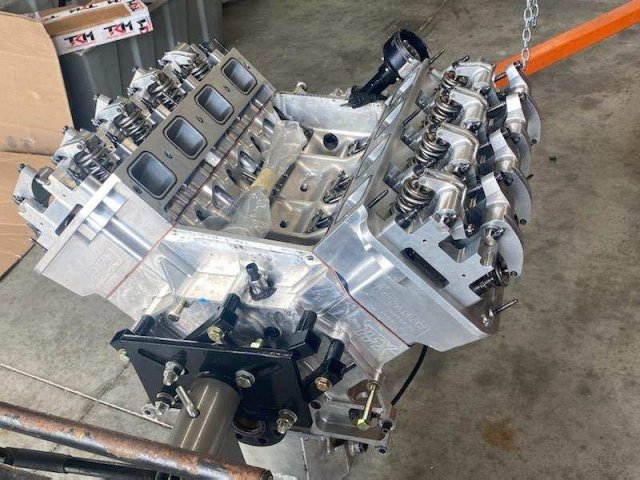

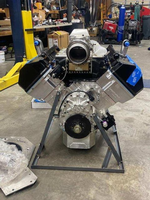

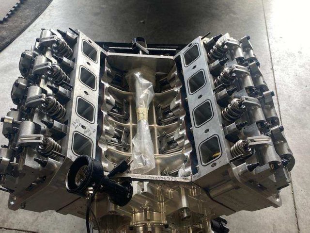

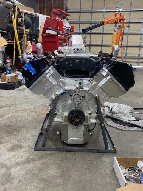

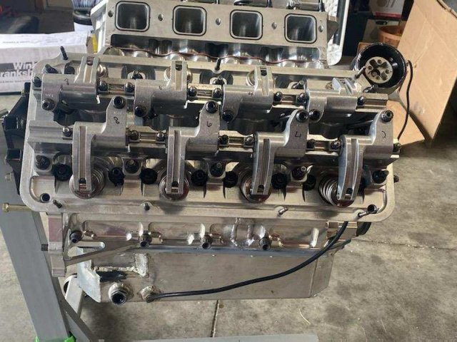

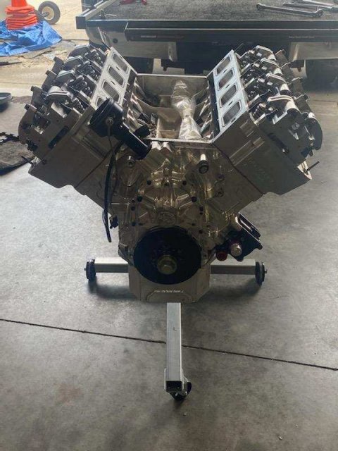

The TFX AJP engine, this engine belonged to Stevie “Fast” Jackson and was run in his Pro Stock car. 9BDBB002-DEFF-42B5-8EAB-F7A56AA5F08A.jpeg 3749052C-FC8B-4946-8F62-DD83CB7EA719.jpeg 5E92DD09-7D9C-4E57-923E-5FB585B566A6.jpeg 9A2E85A6-480A-4D30-9C81-7C1F02AE3FE9.jpeg

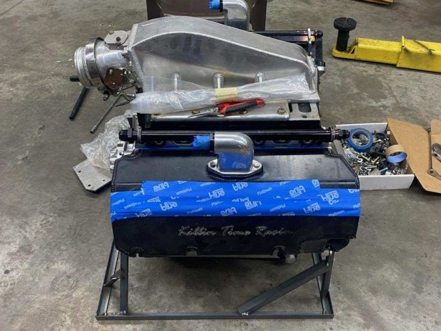

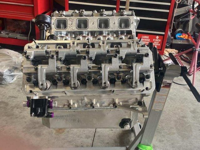

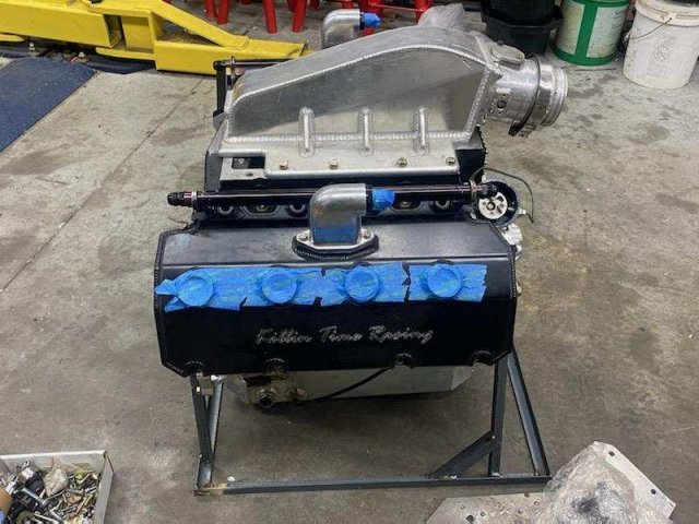

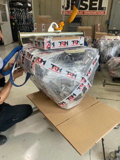

Being freshened by TKMPerformance and now just waiting on the chassis to be finished. BF0B67B8-4585-4807-A118-0789B3B718C4.jpeg BCEF9C06-C85C-4621-8789-F11D25C9E6FB.jpeg D7BA1461-FA36-4A75-A694-7C8B9635D30D.jpeg 77ACFBB6-8788-4A5C-B6A9-F2E84C947AE5.jpeg 0906C0BA-0EAF-4A61-A726-5C1E75AB464D.jpeg E20B4CAF-A202-46D2-B2F4-A0B681805BFF.jpeg

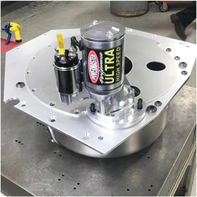

New bell housing and starter set-up. 8E043E5A-7437-4DF9-8939-0FAF3B1A3415.jpeg

The turbos got me curious. Why do they have a pair of bolts across their intakes? Never saw that before.
Precision started adding the cross-bolt safety provision on the discharge size in the competition diesel truck and tractor-pulling world, where the engines see ungodly levels of boost on the order of 100-plus PSI. This will be my first turbo build so some of it I am just learning about it now also.

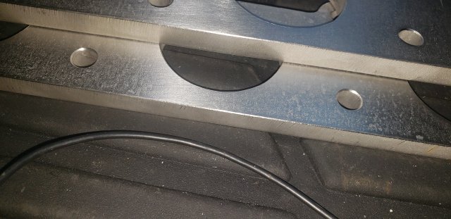

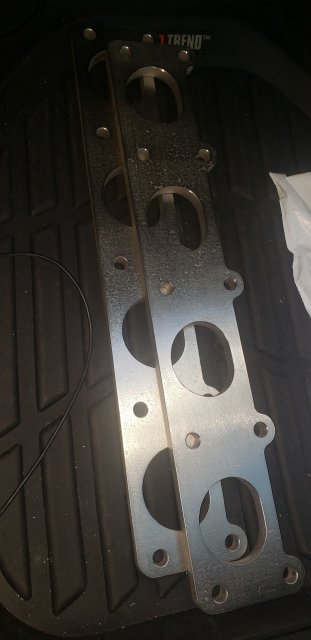

The 1/2” stainless header flanges are cut and ready.

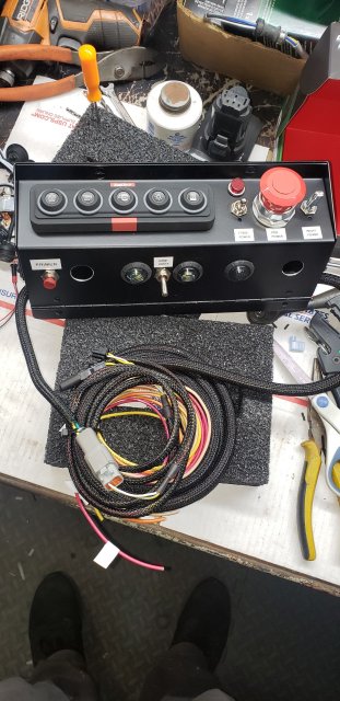

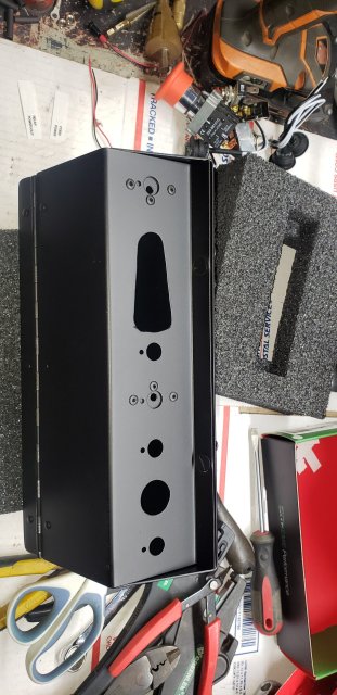

One of the switch boxes is now wired, slow progress. 9500E374-ABFE-4A47-926C-59D77B1ED3AE.jpeg 3F214DB3-CEAF-45D9-9F72-4C31107CEBB5.jpeg

What are you doing for a harness. One of the limiting factors of the ft600 for us home gamers is lack of a harness for OEM like applications. You pretty much share nothing with OEM at this point but wanted to see what you were doing in that area of the engine build.

Thread Starter #18
There will be no oem wiring in this car, it will be a full custom built harness with a FuelTech ecu.
Currently I don’t think anyone has found a way to marry any aftermarket ecu’s with the dodge stuff and make it work because of the tcm (maybe on a manual). I know if you go to a TH400/PG etc it can be done where you still have all the bcm controls and the aftermarket ecu is only running the engine.
@otto - it looks like the charge side, but it isn’t, those are fancy turbine housings. Those cross bolts are to keep the turbine contained within the housing in the event that the center section lets go. Most of the diesel stuff isn’t twins, it’s compound so a turbine could go into the downstream turbo or into the crowd at an event.

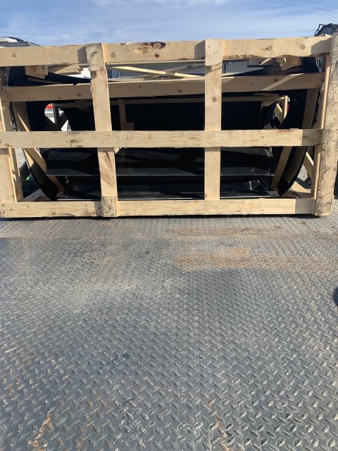

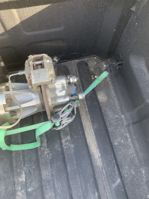

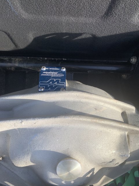

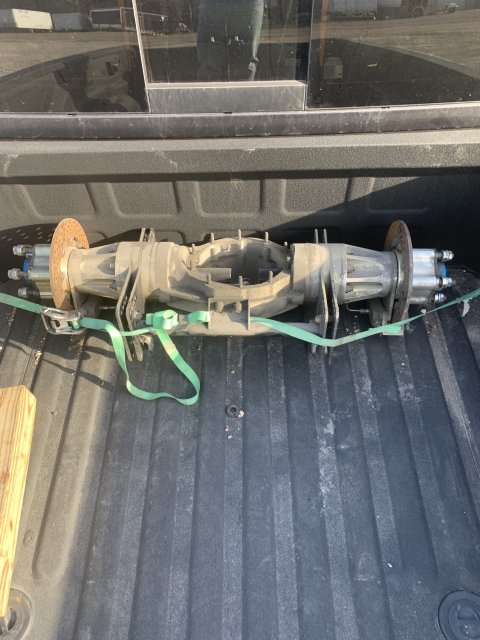

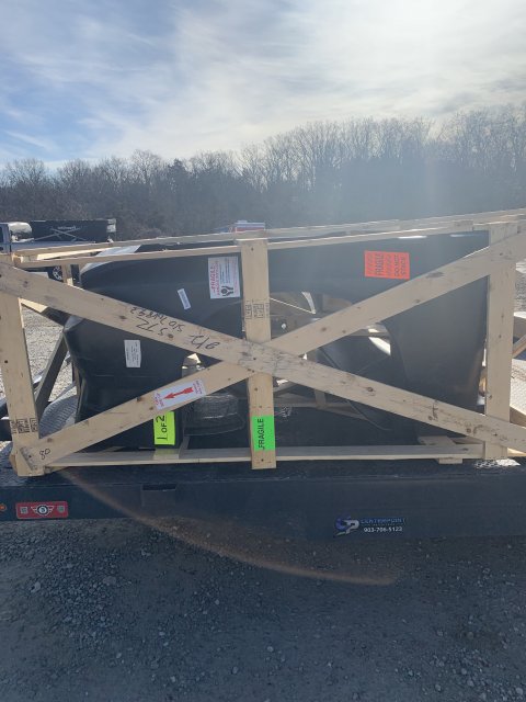

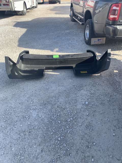

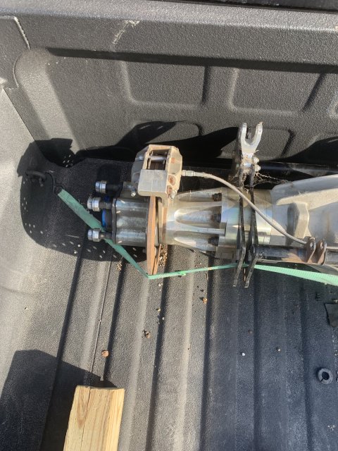

Went up to Larry Jeffers Race Cars this past monday and picked up some more parts so we can keep the chassis guy moving forward. In the crate is a one-piece front end, doors, trunk lid, dash, rear bumper and a hood all parts are built by Glasstek. Also picked up a Mark Williams modular pro-mod rear end, rear-end has less than 10 passes on it and was complete minus the rear gear. Kenny Laughlin(Alex Laughlin's dad) made us a smoking deal on it and we could not pass it up.
