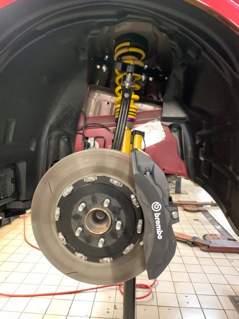

Those were my original hellcat rotors . My new race brake rotors are starting to do the same and I want to stop it before it get too bad .
I guess stopping at 140+ mph on a short shut down area is not good for the Z26's
True that! Those Porterfields will work and won't break the bank. Hawk makes some products that will work for you also. OR, do just short of what I do (I change rotors and pads for racing), change back to your Brembo pads for track use. Then bed and go back to Powerstop for only street.

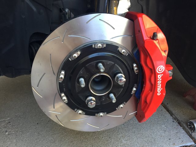

Also went with DBA rotor rings and re-used the OE hats. They’ve been great for street and track both. A little over $800 for the pair if you do it yourself. Easy not to mess up since they’re non-directional.
You use those DBA’s for HPDE use? If yes, what pads, Sir?

I have Demon performance rotors on the rear and race brake rotors up front . I have Z26's on all 4 corners but will be replacing them soon . And yes those are demon calipers on the front .
Yes and easily swap out my front Stop Tech for the OE Brembo pads on track days. I actually bought a hardly used front set of backup OE Brembo pads for a song. I keep the same set of Hawk pads on the rear for both street and track.
DBA has a pretty good explanation on their web site about how they are designed for cooling.
