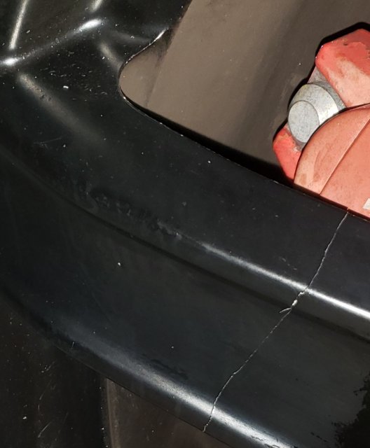

I was examining wheels today and noted a fracture of one of the spokes on my stock 2017 wheels. No recollection of any harsh impacts ever. Anyone else ever see this? 20220104_175249.jpg

This is right front wheel.

Wow. No bueno.

Have seen it before. Maybe on that other forum but do not remember the case.
2,287
5,366
Thought I saw a Mustang wheel cracked but never one of the forged Dodge wheels.

No good J. It is done, NOW.

Never seen or heard of this on our stock wheels, if it was a aftermarket China wheel, I would almost understand it. Anyone up for flying mile test pilot run with this wheel.

Very surprised no vibration from that.

I was examining wheels today and noted a fracture of one of the spokes on my stock 2017 wheels. No recollection of any harsh impacts ever. Anyone else ever see this? View attachment 60821
That could be nasty dangerous, do you still have warranty ?... I would take it to the dealer & see if they'll replace it.
I never heard of it happening b4.

Uh oh. Which OE wheel is that?

I think it's the 5 spoke, same as I have.

As I recall, at least in '19, and maybe '18 too, there were two different 5-spokes. One being an extra $1,000.

the 17 5 spoke, solid spoke
weren't the others a split spoke ?

For 18 this is an optional wheel. It was $1K.

Fortunately i had already bought an extra pair of pristine stock wheels from another member. Been a couple of years, forgot who from, duh.

I took out a seperate warranty on my wheels. Have used it twice and wheel use it again before the warrany is up. 1.5 years left.

Do you drag race or road course with that wheel ?

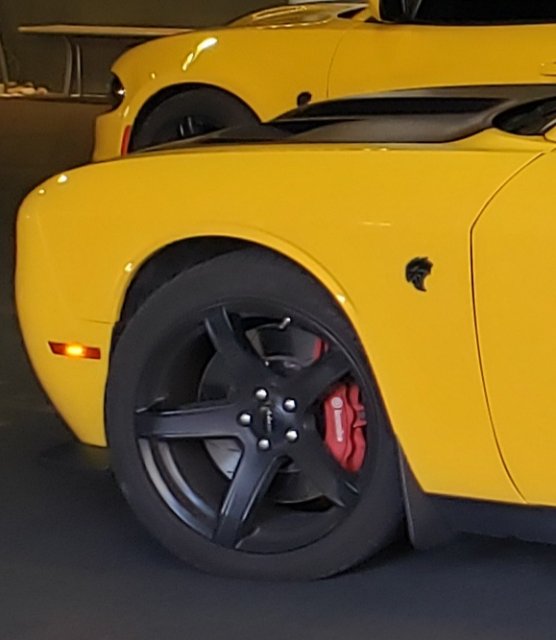

This is same original factory wheel but left front example. 20220104_204517.jpg

Do you think it is safe to drive it to tire repair to switch out wheels?
