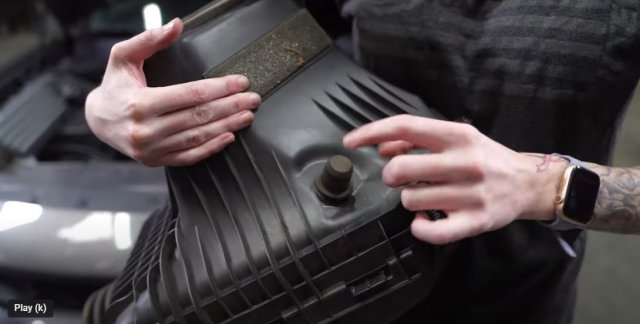

Is this what you are looking for? this grommet hasn't changed since 2005, although I think this isn't in the parts diagrams. That might only come with the airbox.
(pulled from JLT install video)
it just sits in that round hole on the fender well you see below the overflow tank ...

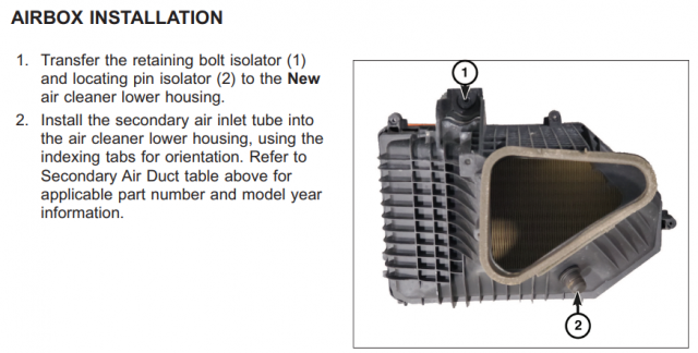

1.) the part name is "locating pin isolator"
2.) reference:
3.) mine has been missing since 2020, it is immaterial to the intake unless you think you have found the death ray's harmonic resonance
4.) you cannot buy them, i think
1,763
5,378
You may need to get the whole lower box assembly as its likely comes together with that. Or pull one from a salvage yard. It should very likely be the same from 2005 300, Magnum, Charger and up. V6 and up, shouldn't matter, that part of the chassis hasn't changed since then. That other grommet and isolator you see in the diagrams are for the part of the airbox that mounts to the top of the rad support.

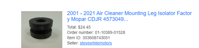

THis is the closest thing I could find using similar description language. I thought it might be a redesign. 1691575881570.png

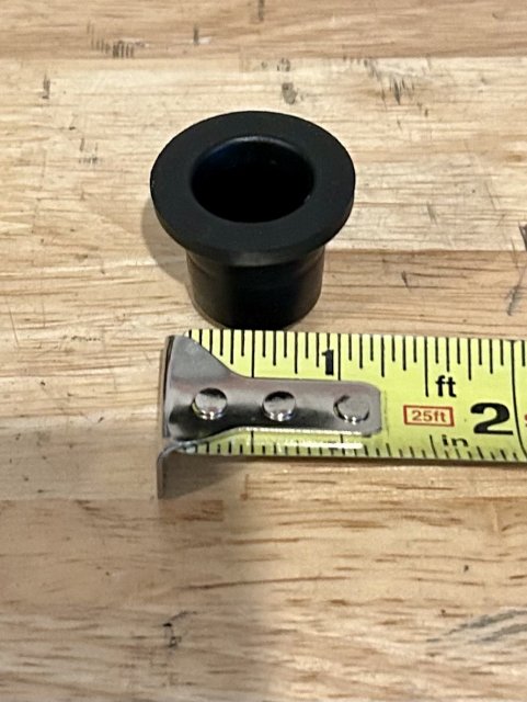

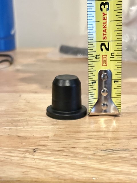

@TheRedKey I’ve got you covered. I don’t know how I came across a spare, but I squirrel away shit in case I, or another, needs it. I doubt I’ll need it in the future, if that time comes I’ll figure it out. PM me your ship to address and I’ll try to get it in tomorrows mail.
