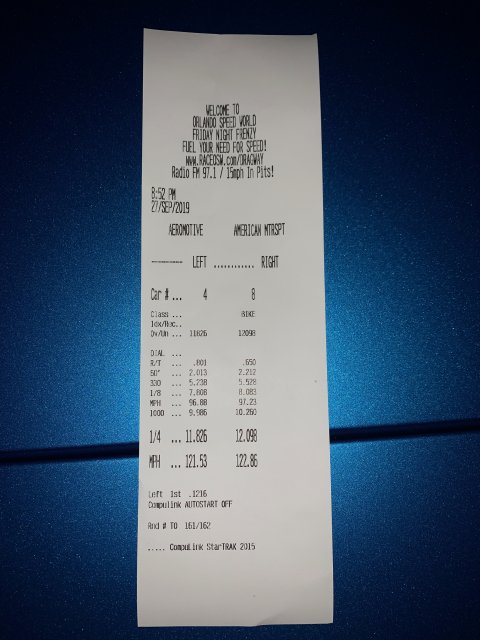

First off, the experience was incredibly fun! Having no idea what to really expect except from what I've read here and watching videos. I highly encourage anyone with one of these cars to go! A friend of mine has a WB Redeye and we met up at the track. We both arrived early, which is the key to having the time to prepare the car and yourself. But even more importantly, the track people having the patience to help you along when you don't quite know what to do. The people at Orlando Speed World were incredibly kind and patient.
On my very first attempt, I drove around the waterbox, backed up, then couldn't get to the line lock button on the screen because the backup camera had the "delay" option selected, so i pulled up slooooowly until the view of what was behind me went away. After that, the air pressure in the tires was too high, which lead to a massive burnout, I stopped, saw the pre-stage light lit, rolled up to staged, but I was actually staged with the back tires in the beams, The track guys thought that was hilarious for some reason.
After 3 not so great passes for me, and the Redeye getting better with every pass, we went out for the final time and actually had a drag race. When I released the brake, I don't know where he was because I was focused, but near the end I could see him next to me, and gaining. This was by far the best pass for me that night.

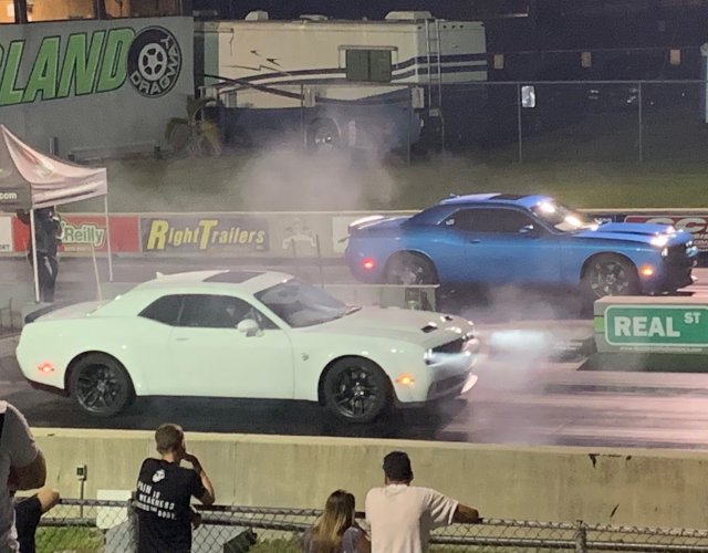

Best picture of the night.

Looks good! I guess you realize your 60’ time needs a little work. With DR’s your 60’ should be from the low 1.7 down to mid 1.5 range. That will greatly reduce your ET. It just takes practice but finding the right tire pressure, a good burnout and staging properly will help you get the best times out of your car. Have fun!

First time out, not bad.

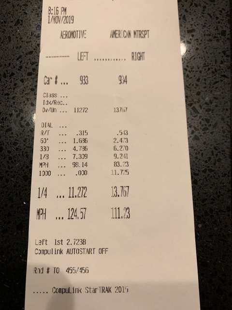

Went back to the track and did much better! On this pass, I was lined up with my son in his 2018 Mustang GT. It was his worst pass of the night, my best one. I must have intimidated him.

(y)60’ time made the difference!

Good to see more people getting these cars to the track where you can actually use the power. You're learning a good ET is all in the 60'. Those Nitto 555R tires will settle in around a 1.6x 60 in my experience. They're what I use on the street. For the track I'd get a set of 17x10 wheels with some Mickey Thompson ET Street R tires. I run a 305/45R17 and can get mid 1.4x to low 1.5x 60 foots. If yours is a wide body you may check on a 315 size.
