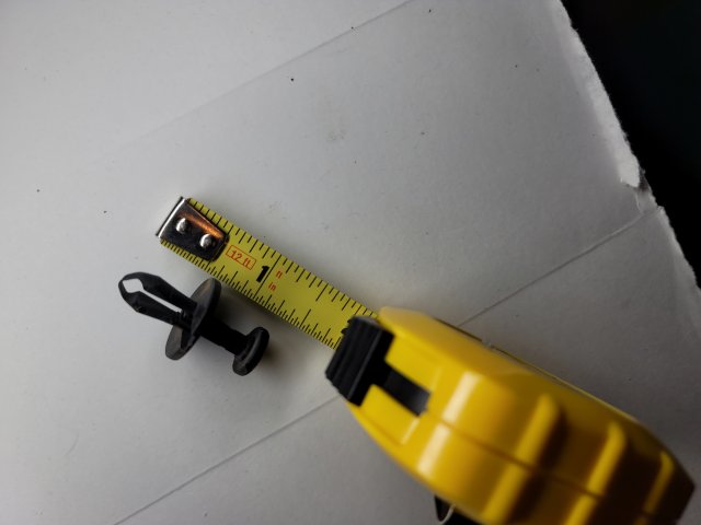

Can someone please take a pic of the plastic push pins on the fender liner to the fender and to the bumper? Or do you have the size/part number? I have the wrong ones

I will now count that as a picture of your car lol. Thanks, just got the right ones. Appreciate it. Lost mine years ago

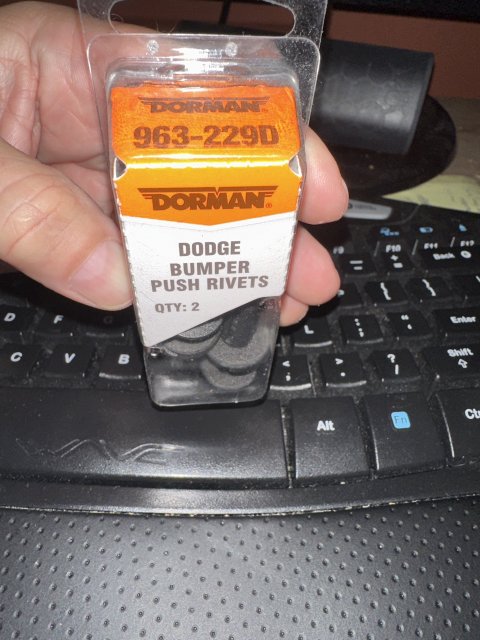

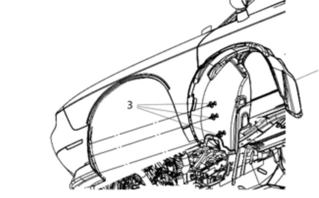

Maybe it's this one, these are slightly smaller, there are 2 per side for this one.
6509049AA
