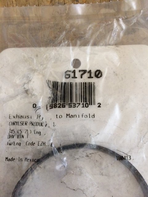

On the 6.2L, I can’t seem to find the part for the donut gasket between the headers and the cat down pipes. Does anybody happen to know an aftermarket equal alert?
I have the mid pipes off on my Trackhawk right now and I’m staring right at a gasket that goes there.
All of the OEM part call outs don’t list a gasket in this location.

You can use nothing at all like most do or use high temp silicone. I have never replaced it when putting cat deletes on
5,176
9,642
I think this is what your looking for ?
5,176
9,642
Same part for both (L & R) sides.

My catless mid pipes that I got from Stainless Works came with the doughnut exhaust gaskets your talking about as well as my Borla S cat back, you could call any of these companies and they’d probably sell you some doughnut exhaust gaskets, even a good muffler shop should have them in stock
You can get at O'Riely auto parts View attachment 30712
Dude. You are THE best. I’ve asked multiple forums and you are the only who had a part number. Fits like a glove.
Glad I could help, I had already been there & done that :LOL:
Take care & good luck.
