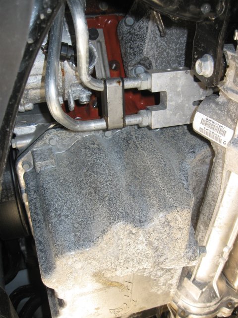

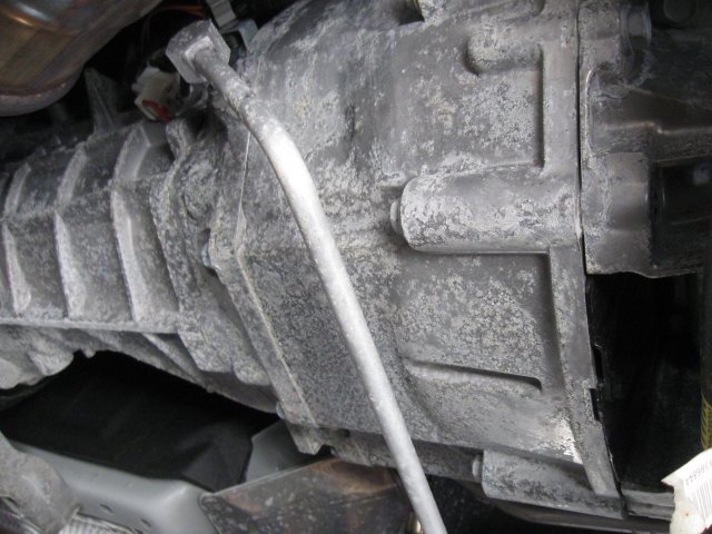

Thanks. The car was 9mo old when I bought it new in VT Sept '20. It was built in Dec '19 and I think it was exposed to salt spray that winter, there is surface corrosion on the alum under the car. Maybe all that sitting over the winter led to it getting stuck. IMG_5129.JPG IMG_5119.JPG

Thanks. The car was 9mo old when I bought it new in VT Sept '20. It was built in Dec '19 and I think it was exposed to salt spray that winter, there is surface corrosion on the alum under the car. Maybe all that sitting over the winter led to it getting stuck. View attachment 89643 View attachment 89644
Yea, could be, that’s a pretty lot of guck!!
spray it down with some penetrating oil like Knock-R-Loose and wipe down with a rag. It will look a bit better and stop the corrosion and etching of the aluminum from getting worse.

Thread Starter #19
If this were a pre 1980 car, the leaking oil would have provided a nice protective coating!
