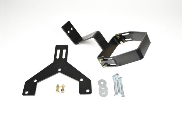

Put in my 4” aluminum DSS. Install went great, had a buddy help and plenty of room for the Barton. Had it up to 95 so far with no noise or vibration.

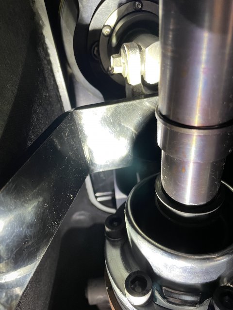

Now came the aggravating part. The website for the track I want to go says you need a ds safety loop for cars running slicks or street slicks. So I put on this g force one for a manual and it does not fit. It rubs the Barton even with adjustment.
The only way I could get it to fit was with 10mm ss spacer I cut that angled it down and away from the Barton and ds. After everything, I wasn’t happy and just took the loop off all together.
I don’t hear many talking about these things and wondering if others are using them? Are they really required? Honestly I really don’t want to put this on my car. If I have to, I could take it to a machine shop or have them make one from scratch that actually fits.

I didn't remove the driveshaft, just the loop. The DSS fit great with the barton. I removed the loop after I added the spacer because I didn't feel comfortable with the top bracket that close to the shifter and shaft at high speed. That's why if I have to have one (which I hope I don't) I'll need to get it machined some to fit. So I'm assuming these are required, at least at your track?

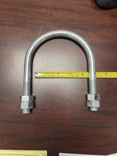

Last time I went to the track they almost wouldn’t let me run because I didn’t have have a ds loop. As much as I hate it, I want to be legal so used a u bolt for 4” pipe, 5/8 thick, and it fits nicely with Barton and dss.
Went from this
to this

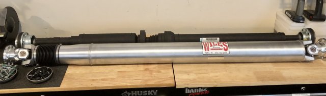

Looks like that will never work for my Wiles, Barton combo.
I was hoping it would. I have that same GForce DS hoop, it weighs a ton and why I haven’t put it on. I had that same Wiles DS too.

Remember how tight it was up there just trying to fit the Barton on top of the Wiles? I remember you helped me through the minor clearance issues we had to resolve.

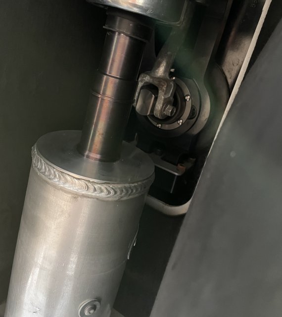

Here is how 4” fits. Not sure the clearance with wiles, looks like It’d be tight but might work. 9267C6D1-3474-4B49-A453-8DDCEE79968E.jpeg

Only thing I can suggest is…. Don’t be afraid to grind on stuff. If something is touching…. reshape it. I can’t tell you how much stuff in my car has had a meeting with a grinder. That included the big fat/heavy drive shaft loop long ago.

Agreed, had to grind the bottom of the Barton as I didnt want to take any material off of the ds which was contacting the shifter right on the weld. Removed just a few mils, no prob.
Yep, takes some work but worth it

Yes, may work, Where did you get the U bolt from?
My work. It's actually metric (M16).
What size pipe is it for? McMaster probably has a SS one too, I’ll have to look
It’s zinc for 4in id pipe. I looked briefly at McMaster and I think the thickest they went for 4” ID was 1/2”. If you pm me your address I send you one of these to try. The 1/2 may suit you better since I believe your space is smaller but happy to send you one of these if you want
