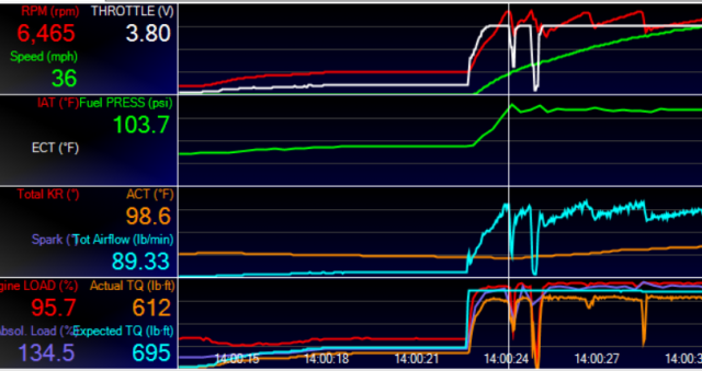

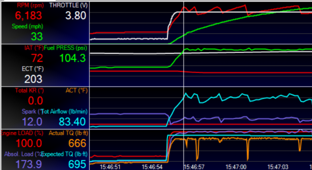

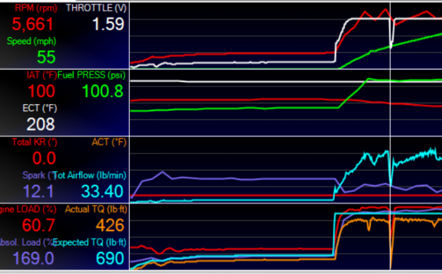

OK here are details about what was happening to my Super Stock. It would hiccup on the 2-3 shifts due to slipping and sometimes in good DA it would hiccup on the 1-2 and the 2-3 due to hitting the rev limiter. Super Frustrating to say the least.
Since I took the heat by some relentless fellows for tuning my TCM, I asked 4 Tuners the following question. The tuner that I was working with responded and the tuner that I would use in the future responded. The other two I never heard back. How perfect.
"My 2020 Super Stock totally stock Tuning and in +1000 foot DA would many times bark the slicks on the 1-2 shift and would make great pass after great pass with no issues. These cars are programmed for a 6400 RPM shift and I am not sure if they raised the REV Limit on the Engine so they likely have less head room. I assume that is why the 1-2 shift is so firm, shifting just in time.
So, WITHOUT unlocking the PCM, and doing a TCM only tune where you can change anything you want on the TCM side, how much, if any, do you think you can improve the ET/Speed?".
The one I was working with said "Honestly, there probably isn't a ton to gain. We can speed the shifts up slightly but there is only so much there. The stock engine rev limiter is 6500 so we can't really shift them any later. That's where most of the gains would be found. "
The one I would use now said "Would be hard for me to say if there's significant opportunities but based on just what you're saying below. In terms of shift points, probably not. Maybe shift behavior/quality but I'd imagine the factory tune up at stock power is probably about as good as it gets so long as it's not cutting fuel for tq management."
So basically tuning the TCM with a Locked PCM isn't going to help. Unless you are fixing a malfunction that Stellantis won't. You cannot performance tune a TCM unless the PCM is unlocked. Period.
So in higher DA the transmission could not complete the 2-3 shift on time when loaded heavy. This is with the 30" tall rear tires, and after adding 100 pounds of balast and at 1500 DA ish. You can see that the shift is commanded and has started pulling down the RPM and then after the fact it clips the throttle to help the shift complete. Plain as day.
The RPM had peaked at 6343, well below the rev limit and was already down to 5661 and then the throttle closed. TRANS SLIP 6343 PEAK.png
This is a double Hiccup in good DA at the Legions event. It hit the rev limit on the 1-2 and the 2-3. It hit 6469 rpm on the 1-2 and closet the throttle and on the 2-3 it hit 6524 rpm and closed the throttle. When the car does this it's an easy tenth slower if not more.
OK at the end of the day I finally got my first revision of the TCM Calibration to try. I am pretty sure he told me he raised the pressure on the 1-2 and the 2-3 shifts, where it had the hiccups. This actually LOWERED the shift RPM's to the indicated RPM where the cursor is lined up and on the 2-3 it peaked at 6205 RPM. And the car set a Personal best at 9.944 because the fuel trims were coming in, therefore the power was increasing (also because the DA was improving) and it did NOT hiccup. I was extatic.
Just to review. I had been resetting the PCM adaptives with HPTuners in the period before I had anything to try as far as tuning the TCM. After doing that the car would make a couple good passes and then it would begin to hiccup as the fuel trims came in and it started making more power causing the hiccups to come back. So, after doing the 9.944 above I came right back and did a 9.908, because the fuel trims were likely fully adjusted and the DA was -500 or so. This was the 6th pass since I reset the adaptives. It also shifted a little higher telling me that it was making more power (part of that was likely because of hot lapping). But NO hiccup.
So, I reset the adaptives 6 passes earlier. With the adaptives reset the first pass was a 9.953. Then it went 10.00 and 10.01 all within a few minutes. In this case hot lapping screwed me because of the added power it hiccuped real bad. So frustrating. Do all you can to have a fast car and the only way it will make a good pass is with shackles.
So, that 9.953 is likely STILL a pure stock record. But you never know. Maybe someone went faster. And the 9.908 was possibly a record if/when the car would work right. And I had DA 1000 foot lower at one point. I can only dream. . . 9.85?
In hind sight, the car many times would bark the tires on the 1-2 shift pure stock. In fact you can see it spun the slicks on the slip log above pure stock. So if it was me, I would just command the 1-2 something like 200 RPM earlier and leave the pressure alone. On the 2-3 I might add a very small amount of pressure and shift it maybe 100 RPM earlier. This would be my 0 DA and lower tune. If I get another Super Stock, I am going to learn how to do this myself. @Speedy!
For a higher DA heavy load tune I would just add a significant amount of presure to the 2-3 and that should do it.
OK, now for the fun part. I ran that 9.953 at 4:19:10 in the Video.
The 9.944 was at 6:08:40.
The 9.908 was at 6:14:15.
