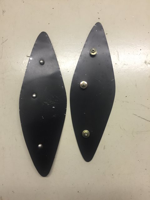

I would never have taken mine through any kind of car wash. I did cut some out of aluminum and used some 1/4” carriage bolts with nuts or wing nuts and washers underneath to keep the water out as much as possible when I hand wash it. They are not water tight so I put a bath towel under each side to help absorb water that leaks through. I also cut one out of a little heavier gauge aluminum with a rubber gasket behind it for the hood scoop to keep bugs and rain out when driving at night or with possible rain in the forecast and on a trip. EA489F55-57E3-4777-A199-47A8A23FCCE3.jpeg

Make a paper pattern and use it to trace on some thin cardboard. Cut and use that to draw the pattern on a piece of thin gauge aluminum sheet that you can cut with tin snips. The right and left side are mirror images (opposite). You can use 3 or 4 carriage bolts and figure out how to line up the holes between the openings in the hood vents.

I would never have taken mine through any kind of car wash. I did cut some out of aluminum and used some 1/4” carriage bolts with nuts or wing nuts and washers underneath to keep the water out as much as possible when I hand wash it. They are not water tight so I put a bath towel under each side to help absorb water that leaks through. I also cut one out of a little heavier gauge aluminum with a rubber gasket behind it for the hood scoop to keep bugs and rain out when driving at night or with possible rain in the forecast and on a trip. View attachment 25223
