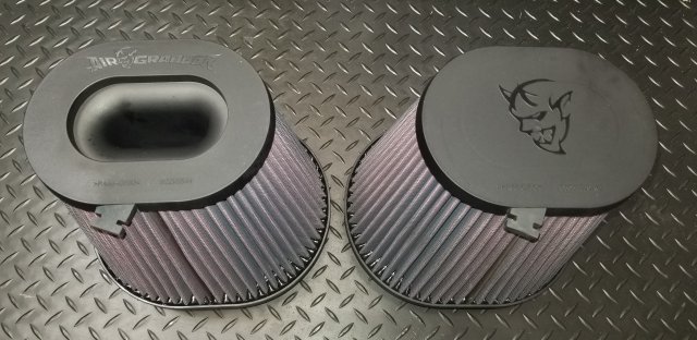

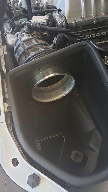

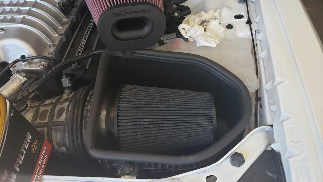

I have the "race filter" installed. I think I have around 105.00 in both pieces. It definitely outflows the demon filter. Lol I should have got the track filter which is just one layer. This one is louder then both filters. 20200427_142731.jpg 20200427_143002.jpg

I ended up getting two of them at $65, because I couldn't quite tell from their pictures how they were damaged. I ended up installing one that has very very slight bends in filter fins. The other one I got is perfect, minus that tab that broke off (just like yours). So I'm going to either epoxy or superglue it back on. I can see how it can snap off. Dodge should have mounted that tab on better. There isn't much that holds it on.
Not sure how anyone else installed their filter, but I just took the 3 torx screws out with the intake still in the car and removed the filter + loosened the clamp to filter. It was kind of a pain to remove those screws, the rubber intake ribs were in my way a good deal, and the screws were in awfully tight imo. Next time I'm wondering if it might be easier to just take the entire intake off, then remove the filter. I also might grab an extra set of those screws, just in case my other ones start getting a bit stripped over time.
Lastly I looked at both Redeye factory filter and this Demon "race" filter and I don't really see much if any difference. I thought maybe there was a hole in the demon center for extra flow, but it's just a fake hole that goes no where lol. Seemed like daylight went threw both filters to me about the same. Once I drive it I'll have to see if I can feel that 11hp, hahaha!
I'll admit for the install, I loosened both the retainers on the intake tube, and it was most easy to just fold it out of the way temporarily without even touching both of the sensor wires. Once free, those three screws are most easy to screw out and back in again.

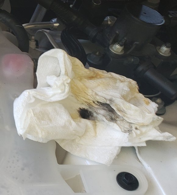

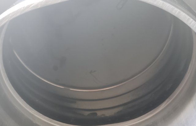

I was surprised how dirty my inlet tube was at 10k with the stock redeye filter. Maybe its pollen or oil 20200429_112022.jpg 20200429_111947.jpg but I cleaned it. I'm running the demon filter now so will see. Pictures of the tube and the paper towel after cleaning.

Yah, hard to say. Could have been a little residual oil that coated inner inlet tube and caught dust/pollen, etc. Wouldn’t worry about that as it’s to be expected with open element filters. Larger particulate would be the concern (which shouldn’t get through any of the filters discussed here, even the Airaid Race Filter).

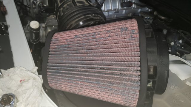

Anyone else see this on there demon filter? I’m guessing it’s from daily driving it in the rain forest of NC. 20200823_103816.jpg

Grungy for sure, always a tough battle with letting it be dirty enough to be at it's optimal point/fine versus letting it get too dirty and then over-cleaning it and having too much oil on it and also using it up/degrading it over time. I haven't put my Demon filter on yet, drag strip has not opened here this year!!! :(
I have 2 OEM redeye filters, which I think is what came on the Demon from the showroom floor, and I've already swapped them just to have it fresh looking when I pop the hood. I feel like our hood snout pulls in a ton of dirt and shit right into the filter, which I guess is the point. These motors can really suck in air!

Funny part is it’s not dirty, that’s just the rain water washing the oem oil off. It did clean and blend when I washed it.
