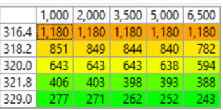

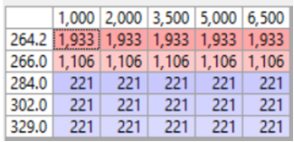

They rescaled and adjusted the max torque allowed at various IMAT temps quite a bit. Anything over 284°F IMAT is basically neutered now. Not a bad thing per se’. 284 is hot but a lot different than before.
