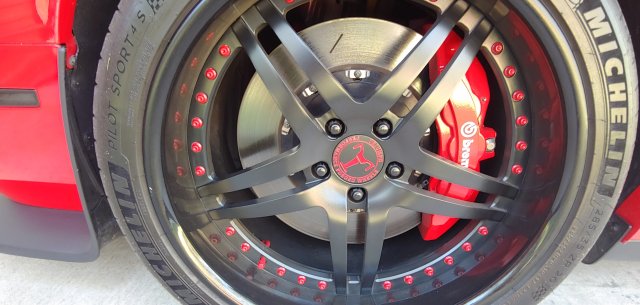

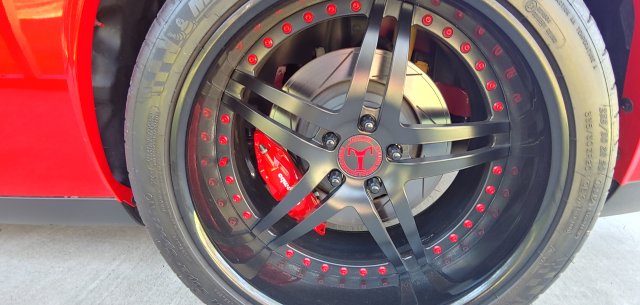

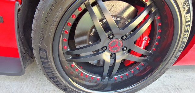

Been trying to figure out the science behind the one and lonely micro slot on the new fronts. Any idea?
It has to do with the brake air ducting and air reflector on the new Cars. I put then on my 2015 as well.
10,568
29,825
My bad.
More than 1.
I'm just a crappy picture taker.
AeroF16
#2826
2,197
7,016
There are 3 slots on rotors like Hunter's. They're all placed at different distances from the center, so they basically span the entire surface of the rotor.

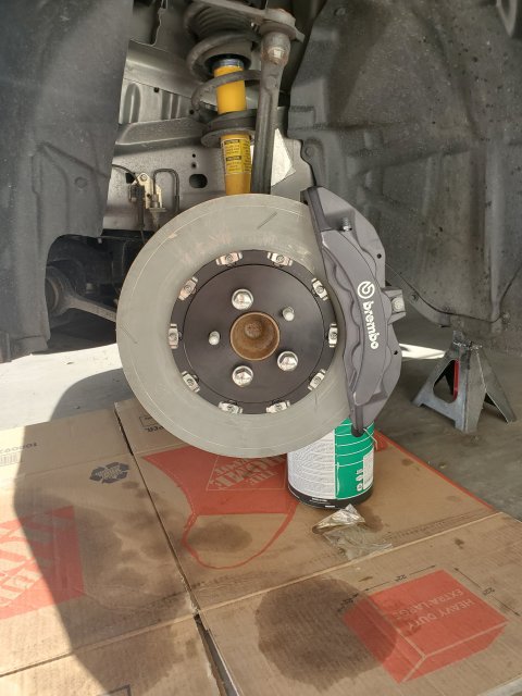

Here's a pic from my old Shaker when I upgraded the brakes...
4,843
25,693
Looks just like my Redeye.
