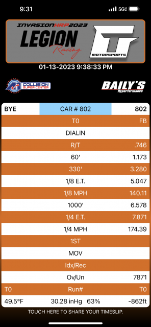

And here's a vid and slip of a 1.173 60', this was on a smaller 125 shot. Although I had less power, how you manage that power is also key. With some tweaks to the tune and how the nitrous ramps in, I was able to improve my 60' from earlier while going into a small power wheelie in the process. At this point it's a delicate balance, if I'm not careful and get over zealous, the car will absolutely stand up on it's back bumper.
