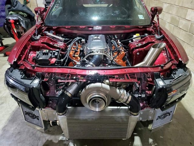

5,847
38,248
Timely thread...I saw a picture of a Charger with what looked like a turbo and supercharger. Been sick so forgot to post picture. Never saw that before.
5,847
38,248
Here it is...
Looks like turbo feeds air to Supercharger? Kinda of cool.
coolblue
#1172
1,577
2,696
Here it is...
Unless I'm missing something that looks like a BIG ASS turbo going into a sheet metal intake. Unless they put the blower on top and its out the hood by a mile. That is insanely big and serious looking. Where did you catch that?
5,847
38,248
Was on Facebook by Ripatuned.
