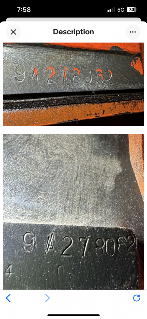

Guys who know 60’s Mopar Vin stamps, do these look legit to you? Top is engine, bottom is tranny. Tranny looks a bit fishy, especially with the over strikes, but I know they are seldom perfect as well. Thanks.

Just from what I see it looks pretty good, but I would also check other locations (casting dates) and verify everything fits - like the VIN vs correct engine/trans, casting dates should be before the car build by about a week or more. A lot of small pieces need to fit to validate everything.
The double stamp wouldn't concern me too much - I think I have seen that before... (just going by memory)

Overstrikes and double characters are very common. The stampings were done by hand after the engine and trans were united and as they were moving down the line. Don't think you hit it right? Hit it again. Remember, none of these guys ever thought any of this would ever matter. Looks good to me.

They look pretty correct to me. I have some contacts. I’ll check with them and see what they think. The engine stamp looks like the original markings to me. Do you have a copy of the trans part number and date code? Also, there is an engine assembly date on top of the block to the right of the distributor. Under the 440 HP stamping there is a month and date stamped in. There is also an engine casting day month and year cast on the drivers side of the block under the freeze plugs. All these numbers and dates are inter-related and have to be consistent with each other

@SilverBillet thanks for all the info. Yup, thats the car. If casting dates on the transmission case work, placing the transmission in the car chronologically, then the over strikes much matter? He said he’s got a David Wise Report on the car. I’m going to call him back today to get that. When we spoke yesterday he was very straight forward and said the car definitely needs paint and bodywork. It’s an older resto. He mentioned it was bought at auction in Fl. I believe. Nowadays though, the cost of that job is waaay more than I paid when I did my ‘71. That more than likely will kill the deal. I realize that buying them done is most often cheaper than restoing it yourself, unless of course you’re in the business. I’m going to call my paint guy today to see if he’d be interested in another mulit-year project. Thanks very much for the info, in fact thanks to all who had input!

More important to validate matching # is the machining of the pad surface. Easy to restamp pad but machine surface is harder to fabricate.

Per the David wise Report I read earlier I’m tending to stay away. There are a few significant turn-offs that make me weary.
-One notation indicates the VIN Tag rivets appear to be aftermarket.
-The engine casting numbers are slightly early, 10/02/68. Assembly date 1/20/69
-Inconsistent cutter marks to factory on engine pad.
-Tranny confirmed restamp, 278 days too late.
Alot of pluses to the car, but for 100k, things need to be better. Pass for me. Thanks guys.

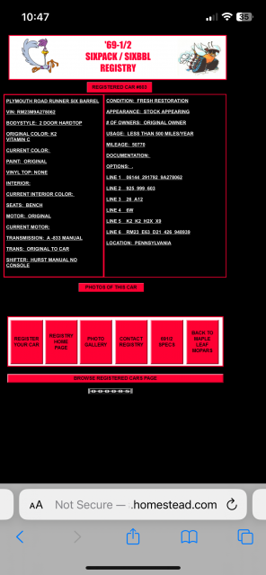

You have a nice RoadRunner @Old Mopar Guy. You don’t see many like it at the car shows. You can easily make sure that you could drive it anywhere. No improvement necessary! An A12 is more of a garage queen than anything. If you had the one in question, it could be a money pit like you said. Take it from experience. I raced and drove mine back in the 70’s, 80’s and 90’s. I enjoyed it but it became a trailer queen. Times have changed. Having a car like that is not the same anymore. I bought the black one in 1972 for $1,750 with 9,100 miles on it and kept it for 24 years. I had plenty of seat time in it. The silver one (platinum metallic) had 7,400 miles on it when I bought it in 2005. Needed almost zero real body work and had a perfect original interior except for headliner and carpet…but I did a $60,000 rotisserie resto on it, most of the work, including the motor, myself except for body and paint. Kept it for 12 years and had less than 200 miles seat time in it. Car shows got old and keeping a truck and trailer has its own issues. I still have a work in progress and not happy about it. Be happy.
