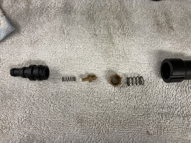

Now I have to figure out to use it or loose it with the BSB. At least it’s not hard to remove and put back in. I’ll see if the stock hose is long enough to plug in direct if it’s removed or not and post. If not it will require removing the guts and putting it back in empty which only takes a few minutes to gut it. Good thing I had a spare as when I pulled the first one apart the guts flew apart and I had no idea how they came out, the second one I pulled apart slowly after learning there’s springs and crap the fly apart when remove. Now there’s pictures here if anyone suffers the same fate lol. Bad thing is it will be months before I’m out possibly, somebody else has to be the Guinea pig first as we can’t wait that long to know can we???

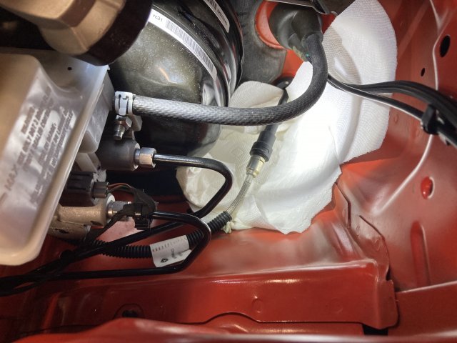

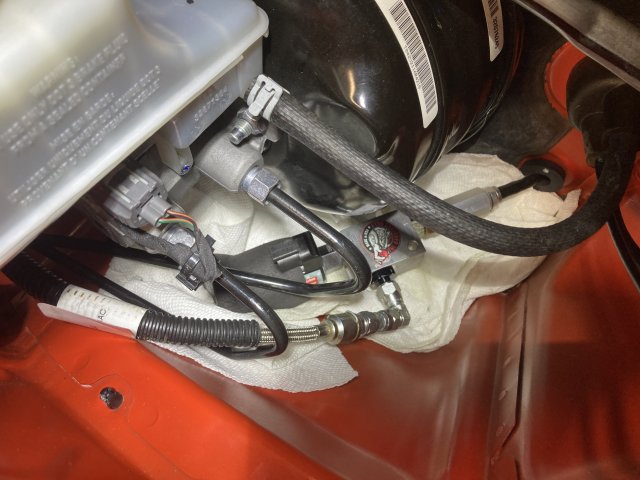

Here it is in the line before I took it out, the paper towels are just there under it to catch the brake fluid that came out which was just a couple drops. See the brake booster to the left? It’s right there in the corner next to the firewall.

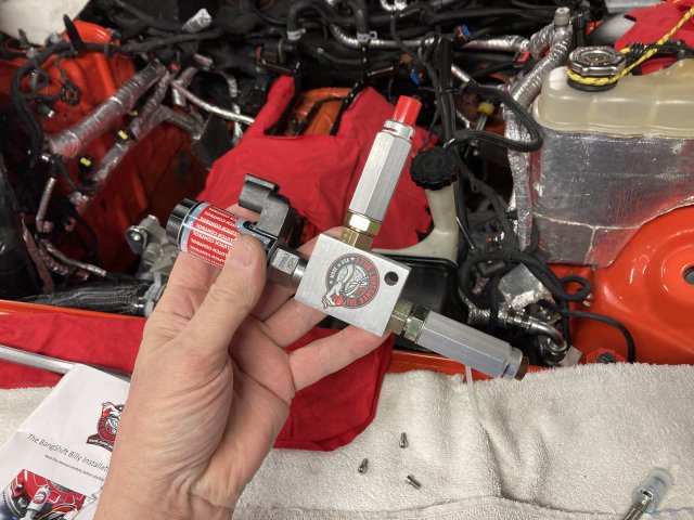

Being I won’t be running for a while (heads still at Thitek) anyone want to remove theirs and see what it feels like? The hose won’t reach with out the black thing, the valve, there but I’d be willing to mail someone a gutted one to put in the place of the stock one. Anyone game? It’s super easy to get out and back in once the cowl is off, which takes about 20 minutes, no special tools required but a push pin removing tool helps get the push pins out across the strut tower brace.
Anyone? Or just remove yours, gut it and put it back in and test the difference. It’s easy to put the parts back inside it and nothing is ruined, it comes apart by removing a plastic clip just like removing the hair pin clips to get the clutch line out of the HRB fitting, all those connections are the same right to the master cylinder.

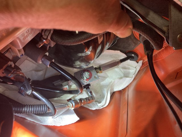

Here is the BSB plumbed into the clutch line minus the CDV. Notice the paper towels barely have any fluid on them, I had it apart 3 times and only a few drops of fluid lost.

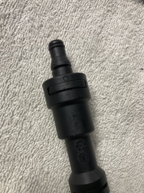

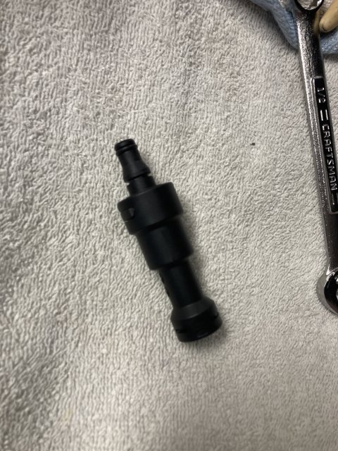

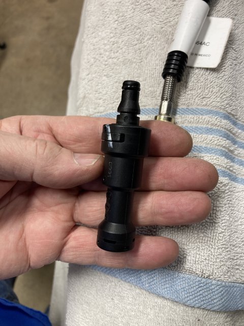

Here is the CDV by itself. See the slot, that’s a plastic U clip that holds the male end inside the unit and keeps the guts inside. Pull out the clip, pull male end out of the body, the 4 pieces come right out, put the male plug back in and put plastic clip back in, gutted CDV, put it back in.
