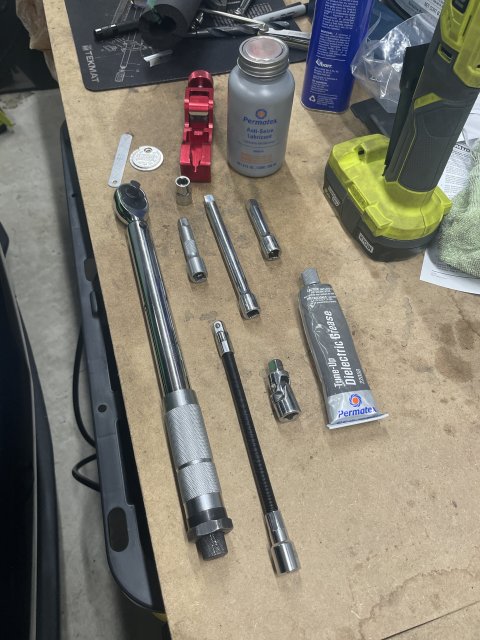

I changed mine about a month ago and this is what I found. I started with the passenger side. Unbolt the intercooler reservoir and roll it towards the engine so you can get in there. One of the biggest issues is disconnecting the plugs. @16GoManGoHC2 posted a tool to help but I didn't have it. I was able to get the first 2 unplugged but even after pulling the 3rd coil pack out I still couldn't get it off but didn't need to. I also couldn't pull number 3 and 4 coils out. @jonx96 had already did his and said push them to the side being the boots are flexible. That side fighting everything took a few hours. After doing it I could cut that down in half. I wouldn't even try to take the plug off of 3 and 4.
The driver side took about an hour. I did take the airbox out and took the bolts out of the coolant reservoir so I could move it. The plugs on this side are facing you so much easier to unplug them

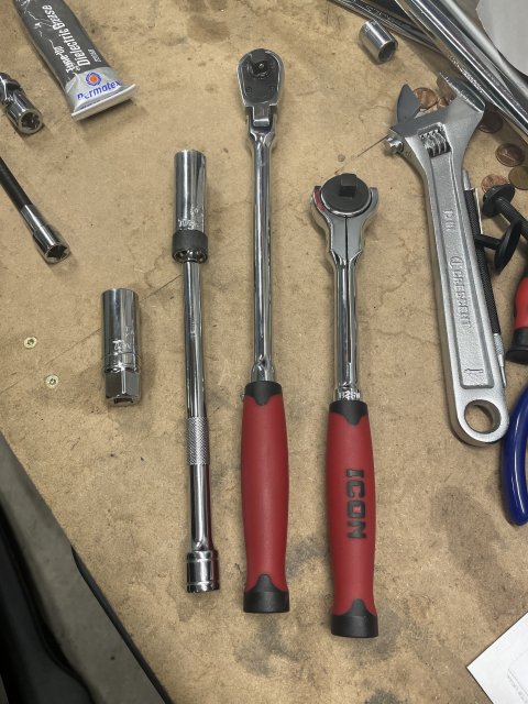

As the spark plug master I'm going to show you what sockets/adapters I use, just woke up and saw this thread...
5D8DC663-E00E-41E8-ADC8-7B1A0AEE0BD0.jpeg AC48D1AC-C31A-4EC7-9D75-8CFEFF574B20.jpeg
the ratchets literally paid for themselves in full for this job, got them yesterday.
View attachment 70783 View attachment 70784
I used a standard 3/8 ratchet, the swivel spark plug socket white1 suggested and different length extension possibly wobble ones on occasion
So Jon and I learned if the plugs threads are shiny you don't need to use anti-seize since they are already coated. The autolites I used years ago were black and for those you do

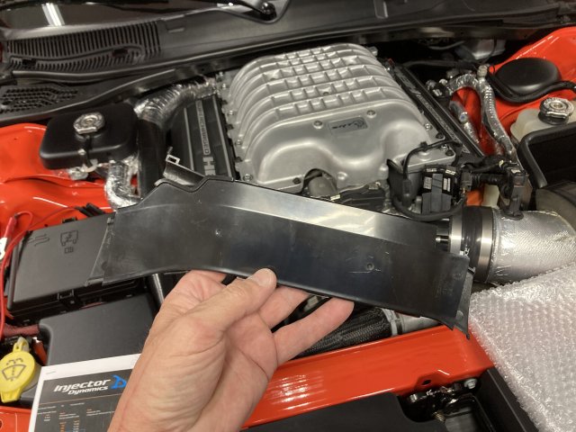

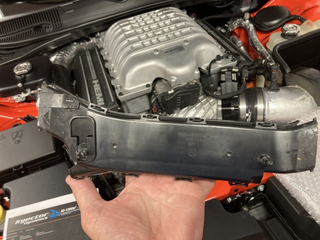

This one, attached to side of strut tower passenger side.

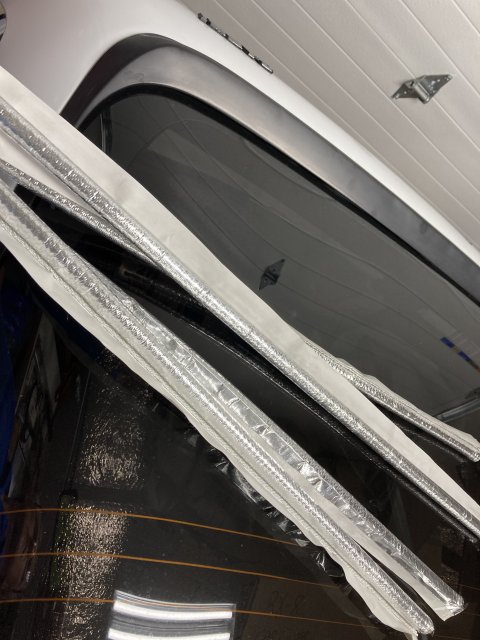

image.jpg image.jpg Wrap wires in this instead, from McmasterCarr
In this larger diameter, self sealing
