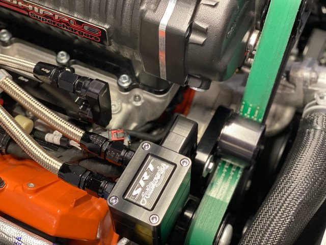

My take is this..... while a little bit of oil getting into the intake isn’t going to be a disaster, a can isn’t going to hurt and it’s a good way of assessing your motor. A tight motor that has a good seal around those oil galleys in the cylinder head is going to see almost no oil at all in a can. If you have increased your boost with pulleys and you don’t have a good seal there, then you’re pressurizing your crank case and a can is a good way to check that. I have one of these...... 259C51A9-EB32-4169-9C48-F45DD5547ACB.jpeg 7B44DE8A-1DF3-4179-87D0-B5E81C1F02DA.jpeg 974E6D00-E9F0-4EDC-8CAB-EC128A9D8A3D.jpeg
