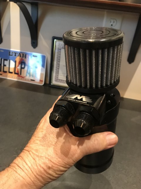

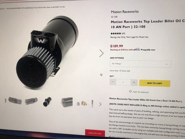

Do yourself a favor and get one of these. Remote mounted. Uses a -10 line from each valve cover and vents crankcase pressure at the top of the can thru the filter. There is no oil returning to the intake. D70D20D9-0E5A-4215-A3E9-DC6897CF7A10.jpeg 2D0A7210-7977-47DB-BFEE-9C747C4791C2.jpeg

Do yourself a favor and get one of these. Remote mounted. Uses a -6 line from each valve cover and vents crankcase pressure at the top of the can thru the filter. There is no oil returning to the intake. View attachment 73313 View attachment 73314

Not sure on how a pulley would work but this is what they call clockable. The mounting bracket can be positioned 360 degrees around the can so it can be mounted in any direction to accommodate the direction the hoses need to go.
