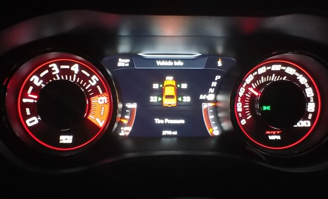

Well my fears have been confirmed, I am pretty much fucked. A tune was put in the car, when we hooked up to the scanner the TPMS feature has been completely wiped out its not even an option. The tool read the tune and as of now it says "aftermarket detected warranty void". Also the rear O2's have been disabled so as it stands now in IL if I get an emissions notice I will not pass emissions. My buddy is going to call someone at Dodge he knows at a dealer to see if they can reflash the PCM to return to stock. Live and Learn I guess. Hope this purchase was not a mistake otherwise I have a nice 48k paperweight to sit in my garage. I seem to never have good luck with cars but its always been my passion and hobby. With my luck who knows what is next o_O

Wait, this should be easy to solve in the tune itself. Was it tuned with HPTuners? If so I believe you can just turn all that back on, I know for sure you can turn the rear O2s back on in HPT. That P1400 can also be turned off (warranty void blah blah).
You could also just buy a stock PCM and have your VIN flashed to it and swap them out, but honestly I'd just get HPTuners and adjust the tune to what you want, then you'll be ahead if you decide to tune in the future, swap pulleys, etc.

Damn, unless someone has since figured it out, the aftermarket tune detected code is stored in the body control module, not the PCM and is not resettable/flashable so it's now permanent, even with a reflashed/replaced PCM.
7,312
19,171
It's been figured out. You just turn it off in the PCM, at least with HPTuners.

Update, so talked to the Dodge dealer (not where I bought the car), and they are just going to reflash the PCM it's 150.00 bucks. I was going to keep this PCM (with the tune) and buy an unlocked one and install it to the OEM calibration but after thinking more about this I don't plan on any Power mods to this car, and will eventually buy an aftermarket warranty. Dealer said this morning there was also another recall for software update (per the Vin) anyway so might as well do both at same time. Car has been running great. As far as I can tell there must be a basic canned tune in the car, probably adjusted the shift points and a few other tweaks. I will find out once it's back to stock. I've bought and leased 2 vehicles from this dealer and also had all the service work done on my Scat there and have always been pleased with the service and knowledge so I think this is the best route.

Good timing actually that you asked me was literally going to post today . Yes yesterday was at dealer they reflashed the PCM 150 bucks and everything Is back. As far as I can tell the tune that was in the car had adjusted the shift points a little in the Transmission it seems now to shift just a tad softer than before but this could just be placebo effect in my head looking for a difference. Power feels the same . My vin according dealer was due for a software update anyway . I took it to my buddy’s shop afterwards to change oil even though oil life was at 70% it looked a little dirty. Changed differential fluid which definitely needed changing. ( 62 bucks a quart Mopar brand from dealer parts ) learned this from my Scat to keep an eye . My power train warranty will be up November 2020 so will consider buying full extended warranty next year . Thanks for all the comments again guys glad I joined this forum
