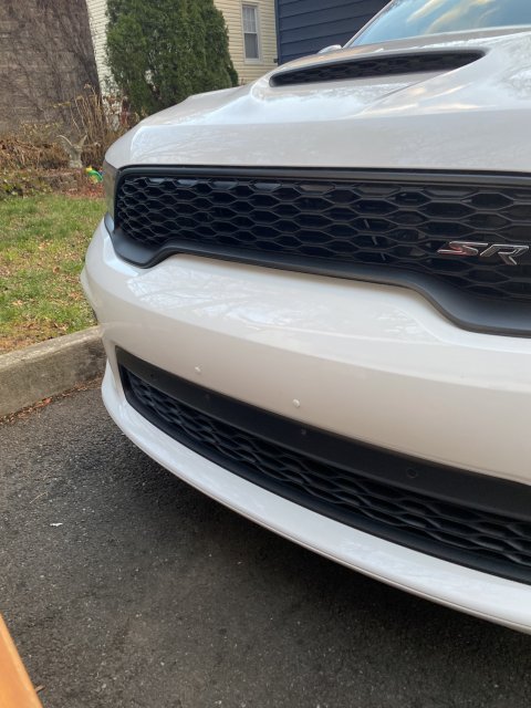

Not sure if you guys have these dumb ass regulations in your state but my truck came with 6 drilled holes in the front bumper for the license plate bracket. Order these plugs, 100% worth the money to save the look of the truck

Bumper plugs.com, they are pricey but they come painted with the Dodge factory paint so it’s worth it, all you gotta do is slightly drill the pre drilled holes with a 9/32 bit and they pop right in 👍

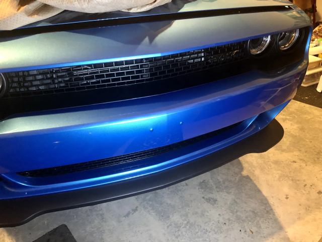

I used bumper plugs that I had lying around. At 30.00 per pair it was far cheaper to pick up some touch up paint that I needed anyway, and paint them myself. First I trimmed the bumper where you can see the material is raised on the edges with an xacto knife. I then heated the plugs with a heat gun and rolled the edges of the heads back a little bit so they were flush with the bumper when inserted. Lastly I washed them clean with alcohol before a few light coats of paint. They came out great. Even though you can can see them from a few feet away it’s better than spending a bunch on a repaint. Moving forward I use a Sto n Sho plate bracket.

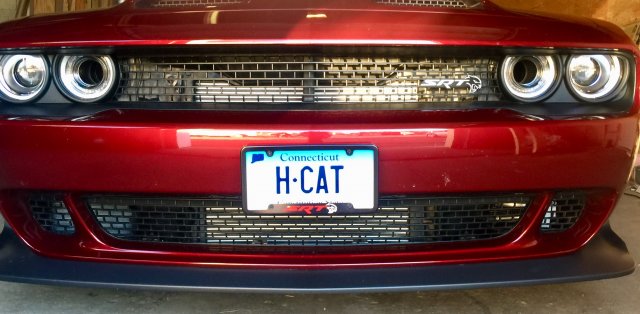

Sto n Show will cover those right up, no problem.

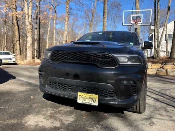

Installed the Stow-n-Show bracket. I think it looks fine. The plate slightly overlaps the sensor but I tested the auto cruise control at highway speeds and different follow distance settings and it worked perfectly.

lol, yes that would have sucked for it to have detected a "car" right in front of your bumper at highway speed
