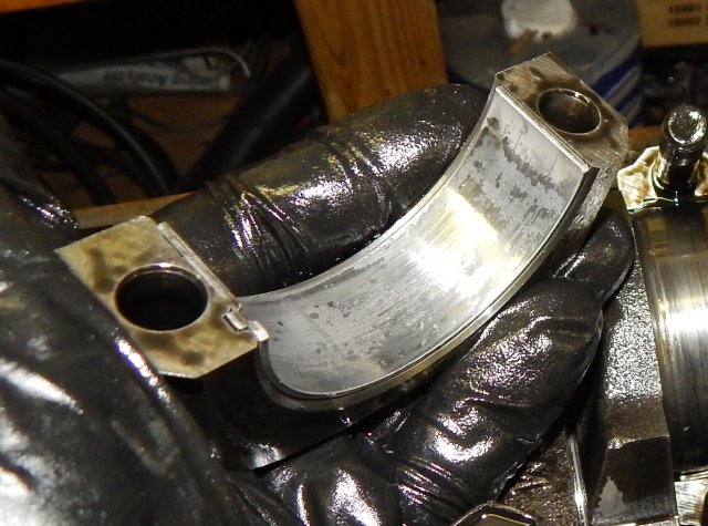

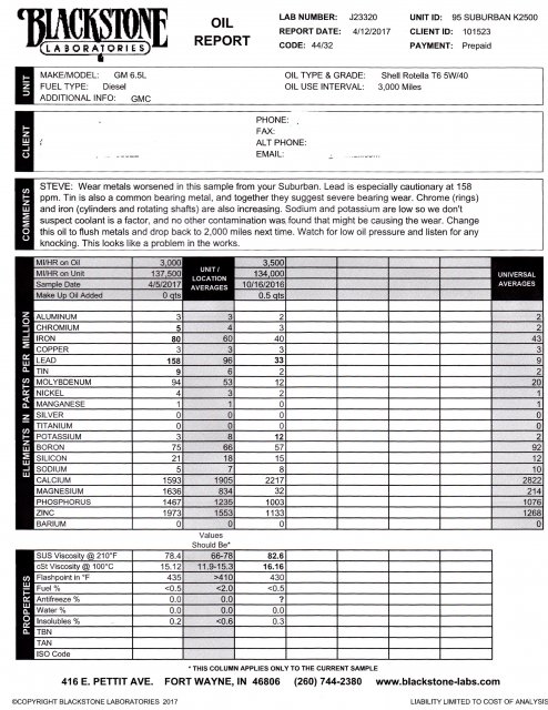

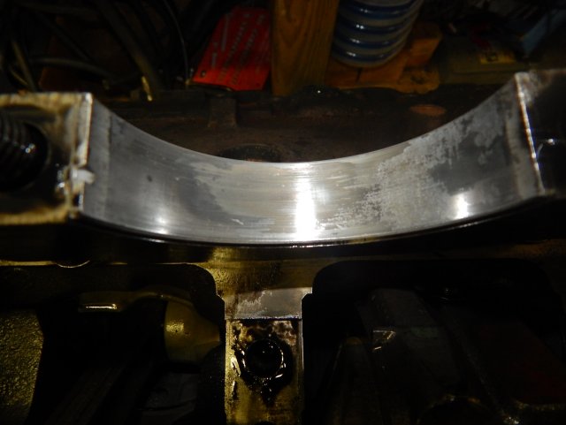

They gave me an exact prediction based on the oil sample, that my 1995 6.5 Diesel in my Suburban was mortally wounded as the result of a head gasket failure/repair 10,000 miles and 3 years previously. They said way too much copper, tin and lead in the oil and you are facing immediately failure. As a result I pulled that engine and installed a new one. When I did the autopsy of the old one, they were dead on: the bearings were flaking away to the base layer and would have spun if I had taken it on the 800-mile family vacation we were planning a few weeks later.

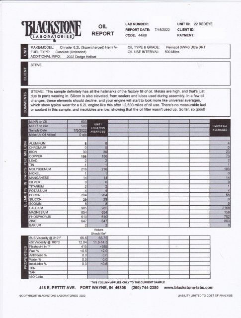

Here is what you get. This was the oil in my 2022 Redeye at 500 miles. (I always replace new car oil ASAP. Now you see why - all the wear-in material was circulating around and can ruin the bearings.)

Make sure you follow the directions...you take the sample like you are at the doctors and giving a urine sample. :ROFLMAO: Always take the sample "mid-stream". Never right at the beginning. And with the engine warmed up so that any contaminants are well-mixed for an accurate sample.
And here is what a bad test result looks like (My 6.5 Diesel's death prediction) and the bearings

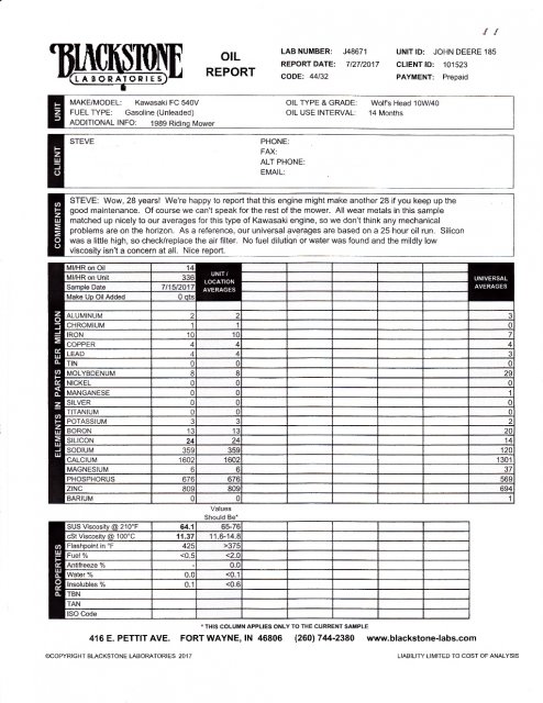

And while we're on it, here's what a great report looks like. My 1989 John Deere 185, I've owned it since new!

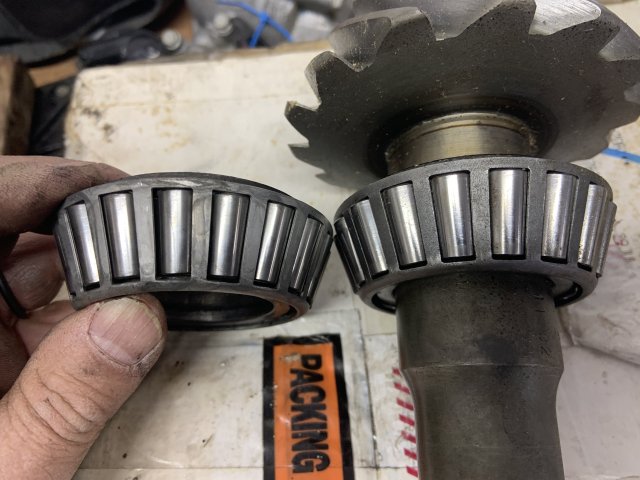

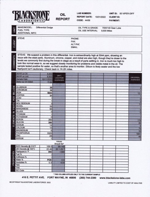

Here's another success story: The rear diff in my 1993 Viper that I've owned since new and used to race back when I was a tech editor at Mopar Muscle Magazine. It has 8,800 hard miles on it in 31 years.
There were no telltales that the diff was bad other than a strange "tinkle-ing" noise when I was under the car and rotating the rear yoke. Turned out it was the rollers in the pinion bearing that had ground themselves down so much, they were falling to the other edge of the cage as the pinion turned. Other than that, there was zero diff noise when the car was being driven. Not that you can hear a damn thing with a Gen1 Viper with no windows and straight side pipes. I would have had no idea anything was wrong until the actual moment of catastrophic failure. The analysis saved the car (and me) probably. Look at the difference in the width of the rollers in the bad bearing on the left and the good bearing on the right.
