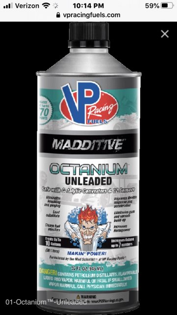

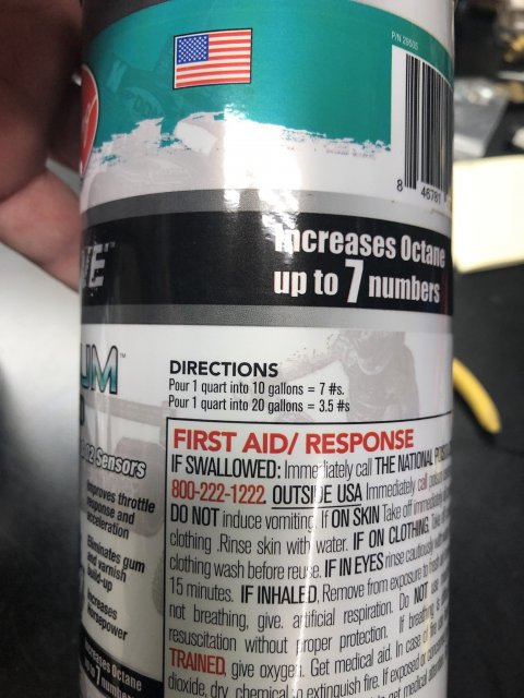

Try a quart of Octanium Unleaded in a1/2-3/4 tank of 93. If the smoke goes away you where detonating. Octanium the best I’ve found to combat a tank of crappy fuel. Do you know how much timing is allowed WOT at 6200 rpm?

Go to Advance Auto and get yourself a qt of this and dump it in the tank, drive it for 10 miles of so to get it to the injectors and do a hit and see if it still smokes. If possible have your son data log before and after.
D9981D87-D6AB-483B-B73A-5E189E9C3783.jpeg C07EE22C-09A9-4F15-A224-2C6C0642DB1E.jpeg
