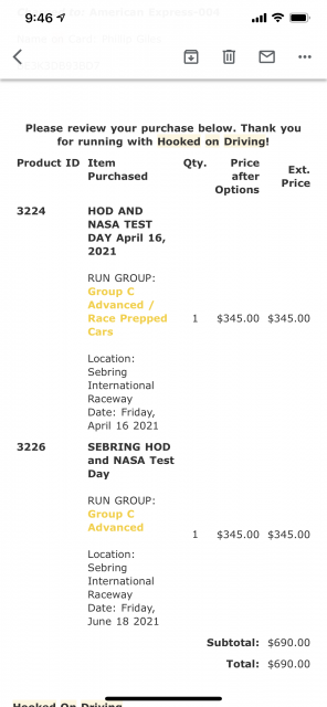

I’m signed up for two track sessions at Sebring.
