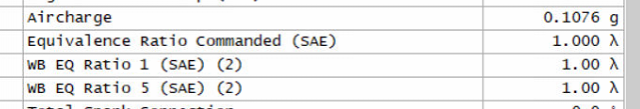

It got worse he went full on pop piston mode 117%. I am attaching channels you should log. You are missing some fueling components that will help you determine how stupid lean you are (which you are). Now this goes with a caveat. Some channels on my PCM may be different than yours, you might have to go back into the channel editor and go find them again. Also I am perplexed as to why your pressure ratio is 2.17. That is way more than stock boost. (2.17 * 14.7) - 14.7 = 17.199lbs, can you send us a picture of your pulley and crankpulley/dampener?

I bet @fumanchu182 adds them for you but I don't think I'd go wot again to even test until you at least get a set of injectors. You need the below tables added at a minimum. Who is your tuner? If you sent him this log and he is continuing to tune you need to find a new tuner ASAP!
Edit- Also add Fuel Mass Cyl 1 when you get new injectors
4,254
10,586
Here you go be good if all you are running is 93. You still may run into some fuel pump issues at that boost level and 93. The pumps tend to get weak over time. On 93 a BAP is fine if still needed after injectors.

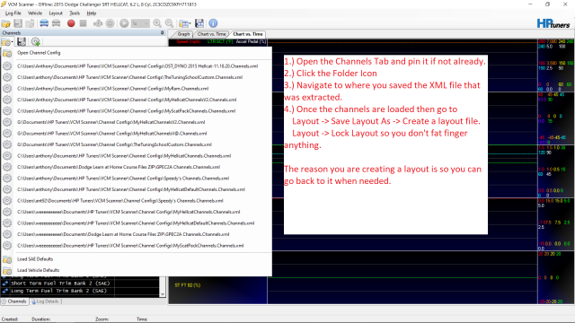

I keep trying to add what you sent but....I'm not computer savy. I downloaded it but cant figure out how to get in on scanner
3,531
8,595
One moment lemme grab my laptop
3,531
8,595
I just installed demon injectors....what I found out is the injectors in the car with that log was 525cc....I bought the car used and I think someone just threw those injectors to sell or trade it. The demon injectors are only 700cc but they should help. The tuner is doing the best he can but and he knows the fuel is wacky even with the new injectors. It having a 2.85 upper and incognito sleeve it's putting out around 17lbs. and I know thats not good in it's self
Demon Injectors will 100% not support that amount of boost period. Your stock fuel pump will not support that boost period. This is an all stop 🛑🚫⛔, you will kill your motor.
So to load the file I gave you, please extract the zip file to a location of your choosing, Desktop or My Documents, make note of the location. Then open VCM Scanner, do not start logging.
