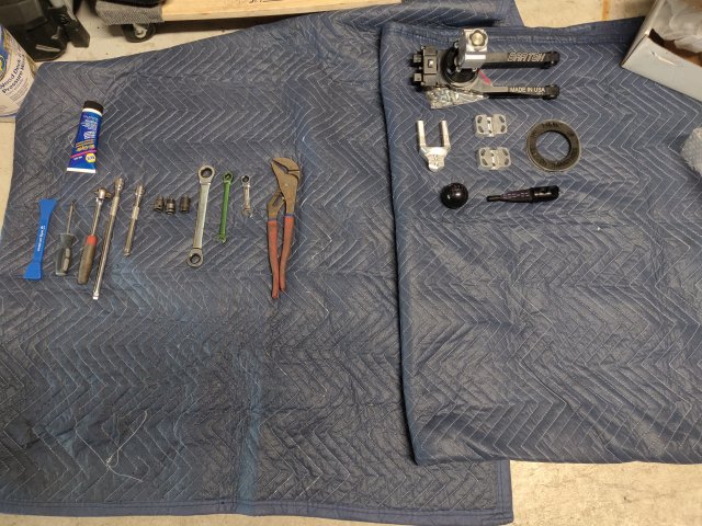

Install was not hard at all, including prep and clean-up, entire install took us three hours, with the hardest part being this clip-pin keeping the shifter's forks attached to the transmission case. I must have dropped it half a dozen times, but thankfully it just falls under the car so it's easy to retrieve.
Some people will say it can be done quicker, but I take my time double and triple checking everything so I do not break a little thing, like a clip or harness, or scuff up the interior while removing the console and related parts.

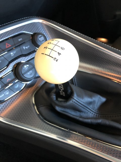

Love mine, easy install:

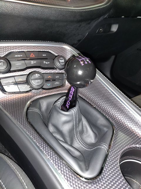

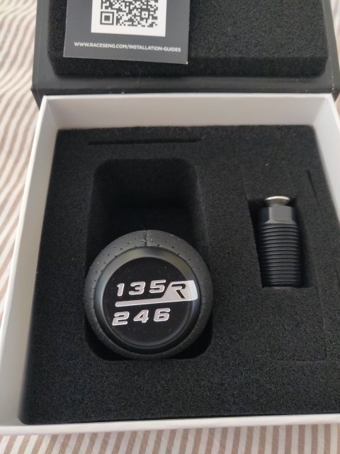

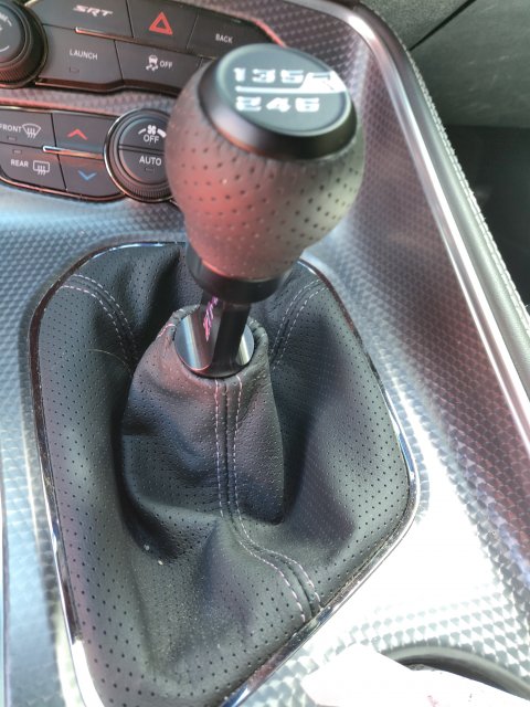

Updating my Barton mini review as I added a couple items. I had a custom shift boot made, this was before Redline offered anything, and added a heavy weight shift knob to match and add weight to throw.
I searched high and low for a heavy weight knob, most forum members purchase a speed dawg knob, so when I spoke with speed dawg they said they do not have a heavy weight knob.
Now we have the heavy weight knob, and it is a much smoother shift. Anyone with a Barton should look into their product offering at Raceseng. Cough cough @Old Mopar Guy
