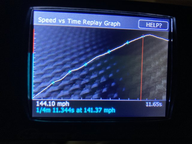

VERY sorry to hear. You know which cylinder let loose? 10.07 a great pass and 141 a great mph for a 2.85 pulley on E85, that’s about my fastest mph on a 2.85 with massaged blower on 85% E making 17.5-17.75 psi of boost top of 4 th gear (M6). (I’m a built engine now, my stock engine was on the edge of letting loose with this same combo last year. Tear down revealed ring butting on pistons 2 and 7, 7 actually missing a piece of piston in the ring relief brow, still was turning 140 1/4’s and making 940 wheel on the dyno just days before I tore it down) That tune I’m running now and then is set up to wring just about everything out of that fuel and boost combo to get 141 out of a 1/4.
Can you post a screen shot of your Alcohol WOT timing table and screen shot or 2 of a couple, or highest set knock sensor table and knock window setting table.
Curious where I’m at versus where your at when your misfortune occurred.
This is the mph I’m turning on street 1/4 practice, pretty much ditto of yours. I’m betting on tear down your going to find the top half of a piston near the top of a bore (loose now but got stuck there from ring butting when it got hot) and the bottom half gone and wrist pin missing as it was the projectile that made the window.

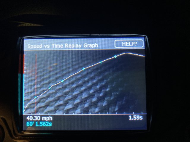

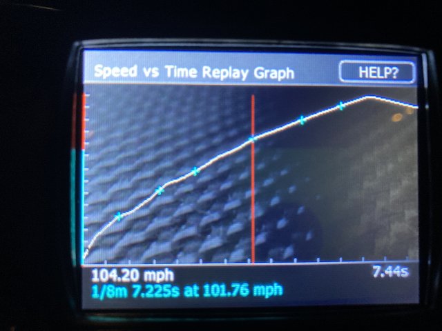

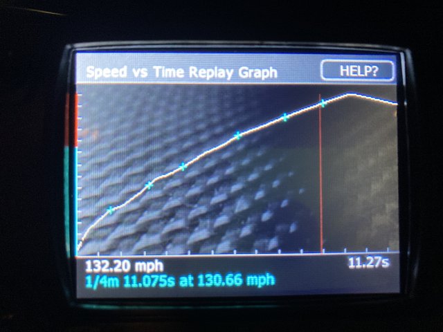

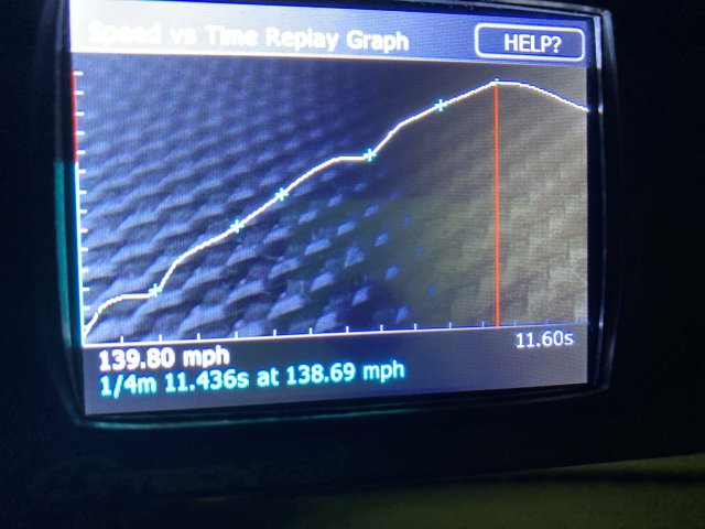

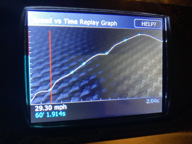

I keep a detailed log of every 1/4 this car has ever run short of instrument malfunction where except for car data data wasn’t captured. I even set my Gtech while at the track and record runs for comparison to track data, the Gtech always within a few hundredths if not closer to track marker times. What I’ve noticed is 1/4 end mph is always about the same no mater if I’m on the track or the street, I use it as a judge of HP being made and it rings true most always. Even if I have shitty launches on the street (usual street 60’ varies from 1.950 to 2.400 and make a big difference in ET but not MPH) my 1/4 mph never varies much, DA makes more of a variance in top end mph then my 60 ft times on the street verse the track do, I track DA with every run as well. Just my observations of 3 years of trying to run 10 second street 1/4’s. . Here’s a prime example of ET verse MPH on the street. This is a 1/4 run on 93, the HP is not there but I hooked excellently due to perfect clutch throttle interaction, closest I’ve come to a 10 second street run so far. It’s too cold here now for good ET’s, I’ll do 141-143 1/4’s in this cold (30F) air but times will be high 11’s. I also use my 60-130 and 60-140 times as a judge if tune changes are making more or less power. The Gtech (and I use a Draggy too to back up the Gtech, I find the Gtech more accurate to track timers so I use its data predominantly)
The 11.4 run produced a decent street 60 ft time but hitting second gear spun like mad and spun again on the 3-4 shift (dips in the graph) spoiling what would have most likely been a high 10 second street pass, that was on corn. The 130 mph 11.0 pass was on 93 where the lower power and tq of 93 made spin control more manageable and produced the best street 60’ I’ve ever logged on the street, if the top end power of corn was there for that pass that would have been a mid 10 second street 1/4 no doubt. It’s a tough thing being quick with a stick, even tougher to be consistently quick with a stick, but when you get it all just right it’s sure brings a BIG smile.
