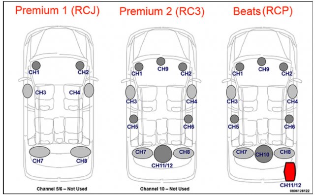

I have a 2019 Dodge Charger Hellcat with the optional Harman Kardon sound system. I have not been happy with the sound but am not looking to spend a ton of cash fixing it. My main issues are the system does not get loud enough and the bass sounds like crap (well really it all does). For now I'm thinking of addressing the bass problem. I don't need massive amounts, just a clean tight solid hit. As I understand it this system has a free air 8" subish thing in the center of the parcel shelf (that rattles a bit when pushed).
I've read Diboblo's excellent post here https://www.hellcatforum.org/threads/how-to-upgrade-the-dual-oem-hk-woofers.4596/ and like this idea but would have to find and purchase the Challenger sub box. Also speakers, amp and such.
I've seen some fit the 10" JL ACS110LG-TW1 https://www.crutchfield.com/S-nnogJSyqg3Q/p_13693334/JL-Audio-ACS110LG-TW1.html in the spare tire area of the trunk with minor modification for fit required. This JL unit is self powered and accepts high level inputs. I would seem to be a simple solution.
My question is, can I use the speaker wires to the factory 8" in the parcel shelf (likely will unplug the factory 8" and not drive it) to drive the JL unit via high level inputs to the powered sub? If so, this is only one channel, how should this be wired to the self powered sub? Can I use just the left channel inputs, or right channel inputs? Should they be split to drive both left and right high level inputs on the sub? Will this idea work with the Harman Kardon system?
Advice, suggestions or ideas? Is this just a stupid plan?

To address a few concerns, here:
No LOC necessary, if tapping off the DRIVER side rear 6x9. The entire passenger side audio signal is reverse biased. Been that way, since 2005. If you tap into the passenger side, you WILL end up with flat bass imaging.
OEM Alpine speakers, including the sub, are 2 ohm. Do not deviate from this.
Yes, you can, and should use the dedicated bass channel wires, if your cat is so equipped (not all Alpine systems came with a rear shelf sub).
A single source signal, for bass, is just fine. Aftermarket wise, you'll be running it into a monoblock amp. Bass is not imaged in stereo, so no need for L&R input, to the amp.
There is an HK dual sub box for sale, on Mordor (the "other" site).
I have provided a download link, in the Tech/Maintenance section, for HC Charger. It includes thorough audio package wiring diagrams.
I'm happy to walk anyone through the bass upgrade process. I am VERY familiar with modifying the audio packages, in this platform.
If you want to go full pro swap, with amps and new speakers, there are very good threads, here and on Mordor.
For reference, my HK dual sub upgrade totaled right around $500, in parts, and I dont plan on changing it. Very happy with the results.
Let me know how I can help.

Thanks for your input, much appreciated!
I'm getting close to just getting the JL ACS110LG-TW1 and trying it out. My main concern at this point is where to tap the source. Is the HK the same as the Alpine (full signal correctly biased drivers side rear)? Does the HK factory amp use crossovers and send different frequency signals to different speakers? If so would it be better to grab signal from the center mounted woofer or the drivers side rear speaker?
Yet another question, does the HK roll off bass bad enough that an LC2i would be worth adding...
I can't find much detailed info on how the HK system works, kinda frustrating. I guess I can just try and see what happens starting with just the self powered sub then adding LC2i if needed. Then getting pissed off and going full bore, the right way. Just don't want to get crazy yet or spend much.
I'll look for the other site for the Challenger box.
Again thanks for the input.

Yeah... like I said... ALL passenger side imaging is reverse biased, whether it was Kicker, Beats, Boston Acoustics, Alpine, or HK. That's just the way Chrysler does it.
That having been said, if you have the base Alpine system, without subwoofer, you should tap off of the driver side rear 6x9, for an audio signal.
If you have a Premium 2 system, with a subwoofer, you should disconnect the subwoofer and tap off of that line, to your new sub amp high side input. If you don't have the OEM rear subwoofer, tap off of the rear driver side 6x9, and treat it as a high side tap, going into your aftermarket amp.
There is a negligible amount of roll-off, above volume level 22. I know there are devices out there, to compensate. In this type of application, I do not think they are necessary. We are not building competition audio, here. The proper way to compensate for this is to play a music selection at volume level 22 and tweak the amp gain and crossover frequencies, at the new amp, until your bass is acceptable throughout the range. It takes some doing, but you can get a very nice playback.
All audio imaging is handled by the cabin amp. That being said, it is compensated for, by also going to the correct speaker. For example, for forward lows, mid-bass (not mid-range) speakers are used, in the front doors. Mid-range speakers are used in the rear doors (if so equipped) and rear parcel shelf. Highs are handled by the tweeters (if so equipped) and by the 3.5" dash speakers. All Alpine speakers, in the car, are 2 ohm. Do not deviate from this, if upgrading the speakers and keeping the OEM cabin amp

I like the Kicker 400.1 amp. Keep in mind that if you are using it with the OEM subwoofers, in the HK box, you will need to rewire the box for an ohm load to pull a 100 watt output from the amp. I posted a how-to, with the re-wire instructions, for the speakers, etc. I think it's in the WIKI.
I upgraded the speakers to a pair of SKAR Audio 10" shallow mount true subwoofers. They are rated at 800 watts peak/500 watts RMS. When upgrading the speakers, you will need to choose a shallow mount subwoofer, as there is a negligible amount of space, inside the box.
Hope this helps,

I got the up grade from the factory, HK, and if there was any more bass from the trunk area, would blow the back wind shield out. I am satisfied,,, for the moment.
I've heard that, a lot. Unfortunately, HC Chargers, even with the HK system, did not get the dual under trunk subwoofer box :( We got a sucky free air woofer that gets about 75 watts, from the amp.
We are adding and upgrading this box, in the Chargers and trying to find a good balance of power and performance. Fortunately, it drops right into the well, in the trunk. All we need to do is add an amp, to power the OEM speakers, or upgrade the speakers and select an appropriate amp to power the lot.

Thank you for the details, much appreciated! I'll upgrade the subs once the rather wimpy stockers are blown...I'll enjoy them while they last.
