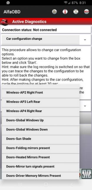

How-To: WINDOWS DOWN WITH FOBIK.
This is a tutorial on how to enable front windows down with FOBIK unlock button.
Video:
https://ve.media.tumblr.com/tumblr_prckzaE8pi1u35mw4_720.mp4
Supposedly, this feature was cancelled in 2013, but Alfa can bring it back!
The command, with the FOBIK, is UNLOCK/UNLOCK-HOLD. That is to say, press the UNLOCK button once, then a second time and hold it down. The windows will roll down as long as you hold the button.
I won't go over saving your BCM flash. That is in the first post, but it should be done, EVERY TIME you make a change, with Alfa.

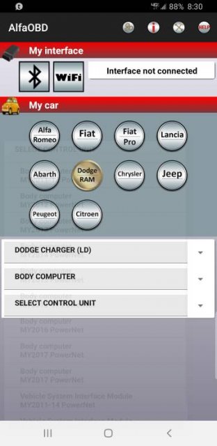

Launch AlfaOBD and choose DODGE/RAM, CHRYSLER, or JEEP. Click the bluetooth button and select your bluetooth OBD client, from the list.
Select your vehicle.
Select BODY COMPUTER.
Tap SELECT CONTROL UNIT and choose your MY Powernet.
Click CONNECT
Click SELECT PROCEDURE TO START
From the drop down, select CAR CONFIGURATION CHANGE
Click SELECT OPTION
Scroll down to DOORS - GLOBAL WINDOWS DOWN
tapatalk_1567400575761.jpeg Select YES and click START once. In the information box, at the top, the current car configuration will appear. It will tell you if your car is set YES, or NO, or whatever variable you can choose from.
Click CONTINUE and wait. Alfa will tell you something like PROCEDURE COMPLETE and you can close the program and turn off the key, or push the start button to the OFF position.
Remove your OBD client.
Grab your FOBIK and try it out!
Enjoy!
NOTE: GLOBAL UP has not been figured out, yet. If you do figure this out, please post it up. Even if selected YES, the windows will not roll back up. If you have a pre 13 LX, what is the FOB routine, to roll the windows back up? Maybe it does work and we just don't know the windows up dance.

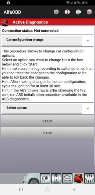

In Alfa, select:
Dodge Charger (LD)
Body Computer
Select your Model Year (MY...)
Click: CONNECT
Click: SELECT PROCEDURE TO START
Click: CAR CONFIGURATION CHANGE
Click: SELECT OPTION
Click: CBC FEATURES - DRL DROPOUT ENABLED
Click: SELECT VALUE
Click: NO
Click: START then CONTINUE
Done!
