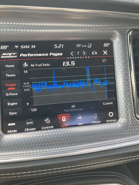

Is it normal for the gauge to spike like this? Seems to spike on deceleration

On deceleration as in if I let of the gas mine goes to 18.
Ok, that is what mine is doing. Thank you

Yeah, there isn’t much demand for fuel on decel, you’re fine.

Completely normal, it's call DFCO (deceleration fuel cut off) and is a fuel saving feature on modern fuel injected cars. If you let off the throttle and still see the AFR doing something other than like 18 then something's up.
