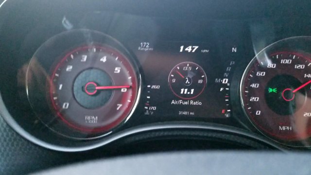

I own a 16 kitty with a 2.85, pulley 775 injectors, 180 t-stat k% n cold air, blowrr spacers and thremo blanket. Tuned on 93.
Question is what AFR should I be running at full throttle? My gauge shows 10.5
So aside from all the other things going on in this thread (some good info in here as well) lol, I run a similar set up to you. I run 93 only and tuned by Barth. My AFR's run around 11.5-11.8.
