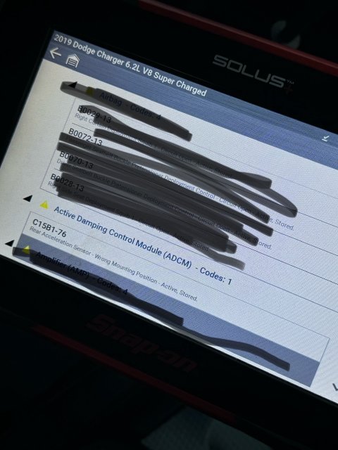

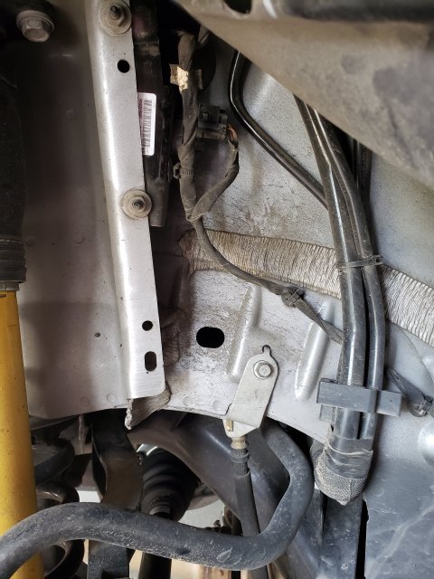

Hello i have a 2019 dodge charger hellcat and bought it wrecked and repaired my self i need to kno where and what orientation the rear acceleration sensor is supposed mounted to strunt tower to make it read correctly an pictures or help would be appreciated THX.

i was unsure where to put the right rear acceleration sensor when i put the car back together and cant seem to find any pictures of inside the wheel well with inner fender out so i can see how sensor is mounted car wont let me change suspension modes with code ctive that is in the above post

this is the sensor i need to kno the mounting location THX

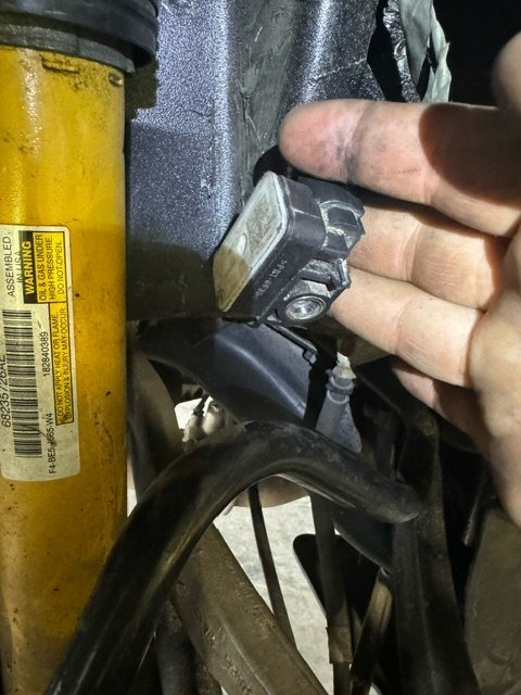

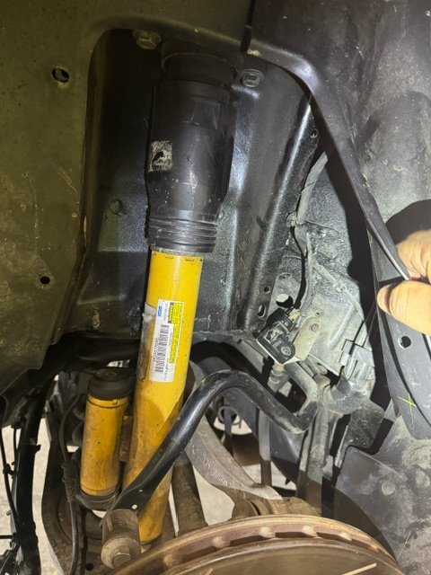

I can pull my wheel off when I get home and take a look if you haven't found an answer
that would be great if you would do that for me and send me a picture ive been to dealer with no results with diagrams for that acceleration sensor its on the right rear behind inner fender that would be such a big help ill let u kno if someone finds it before thank you

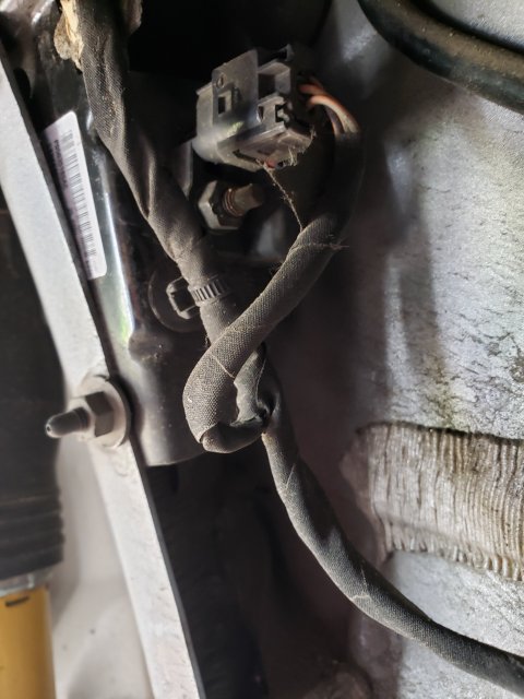

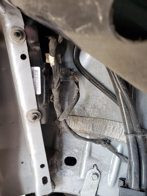

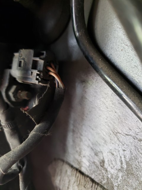

I have pics back there when I had to make room for my bigger drag tires but I didn't take the inner fender out, just cut out a piece at the front. I'm heading home now so have it for you soon

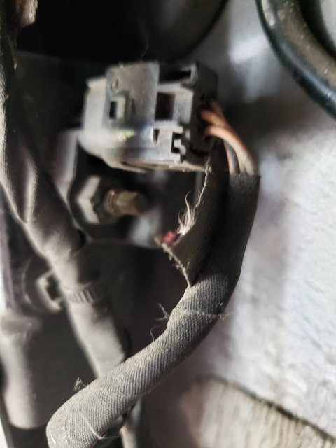

ok thanks your a life saver lol
55,934
189,512
55,934
189,512
Looks like it is mounted to a bracket
55,934
189,512
