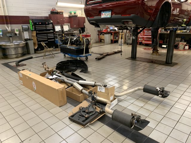

Don’t half do it. IMO AAD does have the best adjustable arms for a compromise between track or strip and street use. So you have that part right. But....
I am installing all of that correctly (picture at the dealer today) and not cutting bolts. Plus the important part is to add cradle bushings also. Then the cure rate for wheel hop increases dramatically.

Holy chit
8,599
52,827
Looks worse than it is. Those damn cradle bushings are a bitch on a new car! Glad he did it. Those guys who do it on the car get medals. He used a saw and a press. We should be on the alignment rack in the morning having a good time;)
