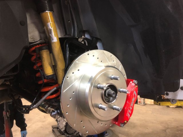

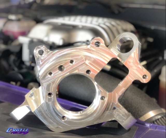

Anyone running an AAD Drag pack along with Carlyle racings new 15" billet no grind knuckle?
Couldn't get an answer if they will work together without issues or grinding (Contact on arms, wheels, etc.)
Some serious coin for the full conversion! Would like to figure it out otherwise may stick with 17's to keep things simple.

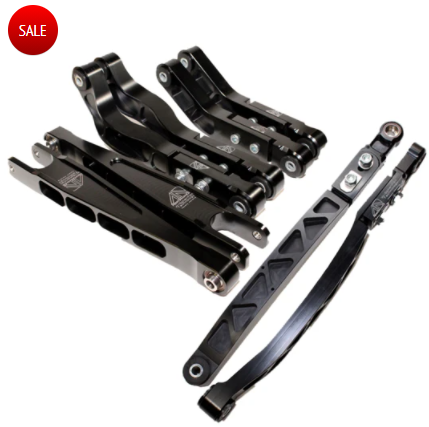

Carlyle Racing said they would only sell the full kit with modified BMR toe and adjustable trailing arms. No options to upgrade or anodize the raw billet.
Would really like to run AAD's hardware on my setup with the new Spheriflex bushings instead. AAD states they will clear almost all 15" wheels with no grinding. Hellcats with BMR are having odd clunking noises with heim joints so trying to stay away from those on the car.
50/50 right now for doing the 15" conversion with 275/60/15 MT Pro or sticking with 17's on a 305-315 ET Street R.

That’s exactly what I was running. There are no issues with the AAD control arms and spindles. Cleared my Billet Specialties WinLites with no grinding. The only issue is the billet adjustable swaybar links that comes from Carlyle are too long due to the mounting point on the new spindle being raised. I had to shorten one of the threaded heim joints so that it could screw in farther to shorten the link. I had the first Billet Spindles sold to the public so they may have made that necessary change to the links by now. I just sold my BMR pieces separately. There’s a market for those out there. I suppose you could use the BMR toe arm. Those are nice but I wouldn’t use the trailing arm over the AAD.

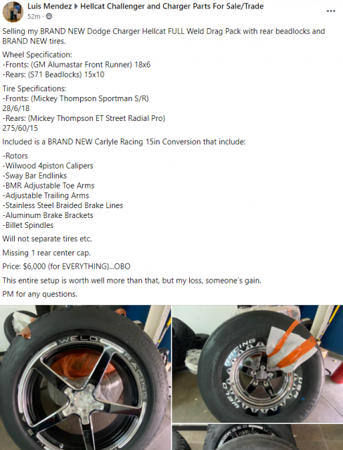

There is a guy on Facebook selling the exact setup i want with carlyles package but wants wire transfer or cash in person. Wont do paypal(n) Way too far to drive but could be a solid deal for someone down in Texas. That is if it's a real ad vs. all the scams. Guess i'll fork out a little bit more for factory direct new. Might be worth doing a 426 first but wouldn't be able to go fast in the car on 20's :unsure:

I saw that. Good deal for somebody local that could pick up, but that’s a lot of money to risk for the savings. I know that some don’t like PayPal (I don’t particularly care for them either) but I have it and use it because it makes things work. That’s a lot to ship too. A lot to go wrong to save a little money. I wouldn’t do it either.
