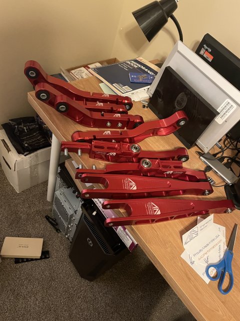

Now it's my turn lol. Installing this today.
59,723
207,969
You bought those pretty red ones that will clash with the rest of your car. They would have matched my interior:unsure:
4,087
10,234
I'll spray paint them black before I put them on, say goodbye to the red.
59,723
207,969
Good luck on install. I'm sure at some point I will be buying these. You doing anything with cradle bushings since you are dropping it?
