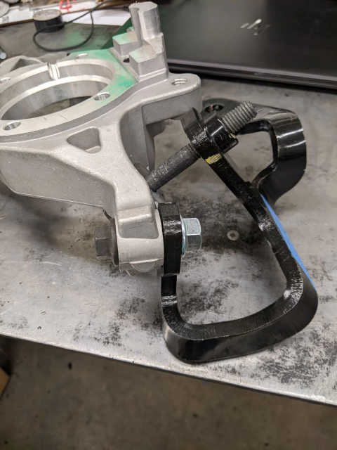

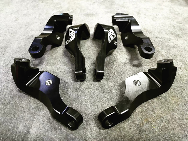

Demon 170 has a steel bracket we all wondered what it was there for. AAD made a better version that all Hellcat owners could buy to strengthen that area that is lighter also. Plus it may be hard to buy the bracket from Dodge

They said it knocks 7 lbs off. There it is. It’s a part of the weight reduction stuff for the serious 170 guys who are competing with Ron. Yes even if the bolts are potentially an issue, a simple upgrade with those would suffice. But when you start adding up all those weight saving parts and pieces that are approved bolt on replacements in the 170 record setting world, this one will be one of those.
