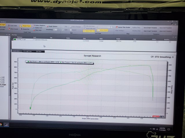

Hey everyone,
Here's phase 1 of the build:
JLT 3.0 catch can
JLT CAI
SW Catless midpipes
Flowmaster FlowFX CatBack
1200cc FIC
Tapped performance dual pump kit with external filter
Bwoody crank pin kit
Bwoody street heat exchanger
Brisk plugs
180 stant tstat
FAS 2.59" (Coated in non-slip grip)
Ripa infinitely adjustable idler
3.09 diff
DSS 1400hp level 5 Axles
NüR Performance e85 tune
Firestone Firehawk Indy500 305s on factory HR5 matte vapors

If I were you, I would install these supporting mods before adding power and learning the car at stock power.
Reasoning, upgrading to a great tire has a greater possibility at stock power of snapping the DS or breaking the Diff. Then when we increase power, DS and Diff will snap if not upgraded.
Moving forward:
Charger RE DS
DS loop
Diff brace

Any concerns with belt slip even after you've gotten the idler and the grip-tek coating?
I would just say, consider a 10% lower so that you can run a larger upper and help prevent slip/fail of the belt.
Several people are successful with small uppers, but it seems to be luck over consistency. You may need additional belt reinforcement.
Otherwise, looks like a great build.
