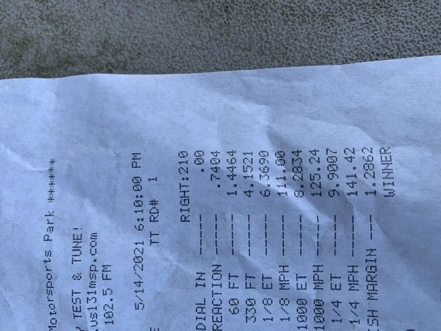

9 second pass w/ 2.85

Just to clarify - your 9.90 was on E85 ?
Yes. The computer was reading e70. I probably still had some left over 93 in as the tune was just finished.
I checked at the rail though and it was reading e85. I think it was still learning. I really think I'm going to be able to get into the low 9.7 range maybe 9.6. If the computer was reading e70 I'm guessing timing was being pulled because of that. I used a different laptop to data log and had the wrong tables loaded. I am really kicking myself for that. So I can't go and review anything.
I see you have you said you did a 9.77 @ 141 on 93?. I didn't realize anyone went that fast on 93. Was that full weight? I'm also guessing the FI Spacers / Blanket and 3.09 helped a little. 3.09 will be my next as I bet it knocks a good 10th off.
DA for the pass was around 1400 or so.
